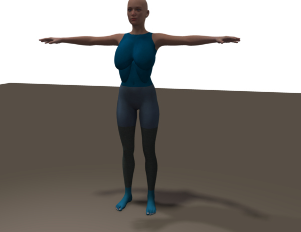

Ok, so I have searched everywhere and I cant seem to find anyone with a straight answer, but then again I have never seen this question. So I am using a genesis 2 female and I wanted to make her breasts move naturally when she walked. so I set up the soft body physics but for some reason a second pair of breasts appeared to come out of the figure. I tried a T pose figure with the similar conditions, but and it seems to still be occurring. is there some condition I have forgotten to check or is this just genesis 2 being genesis 2. below is picture of this happening I have set the internal pressure to .5 and the mass is 1 all of the settings are default. Below is a sample of what is occurring.
Image removed because of nudity
sorry is this what you meant I colored the skin all blue to look like she is tight clothes.

    Please repost your image using an untextured figure, or using Smooth Shaded view style assuming the base colour is white or grey.
    I have seen the double-mesh issue occur in other situations - try turning SubD off first and see if that fixes it (obviously not a usable fix, but a test).
  • McKMcK Posts: 4
    You were absolutely correct.
    I had wondered why in the properties section for the genesis 2 character the SubD had been grayed out. You just solved 2 mysteries. Interesting though wehn I up the SubD in the properties section I do not have this issue.
