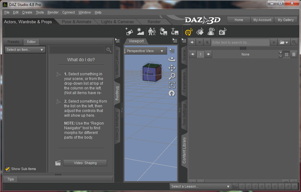

Being new to Daz 4.8, after updating 4.7 funny things happend...all Smart content were moved to Content Liberary and left the left pane completely blank, to show content liberary I have to click pose and animate.
What went wrong or what I have mistakenly done to mess up items and panes like that?
Your help will be heartly appreciated

It looks like you have closed up the Content Library pane by mistake. Click where shown below, and that should open it up again.
Smart Content needs to have either the CMS running if you still use Valentina/CMS, or PostgreSQL if you use that. Did you change to PostgreSQL using DIM, if so, did you run the conversion program which is also available through DIM?
You could try reimporting Metadata from the drop-down menu in the Content Library pane.

You can also reset the Workspace layout by going to Window>Workspace>Select Layout. The "classic" layout is called Hollywood Blvd (for some reason).

I have taken all steps mention in your reply and even some suggestion from other links you kindly gave me
but the situation is still very happy to go on
1-Procedure I made
reset database
re-imported metadata
Nothing changed, then I checked to see if the port CMS is being blocked by your firewall, it wasn not
2- Un installed daz completely and reinstalled it again using DIM..the situation still the same
Is there any other suggestion that can help getting rid o this situation..sorry to consume your time with
my situation..and many thanks again
Sincerely Dr. Atef Sawi
Are you referring to the Content Library pane not showing in 'Actors Wardrobe and Props', is that still the problem?
If so, please look at my previous post, and click on the place marked on the image, you have closed the pane by accident, and that will re-open it for you.

Finally the situation became normal
I've just installed PstgreSQL CMS 64 bit, started DS and did reset Database the reloaded Meta date, started DS and....pleasantly it worked
normally

I see that you now have your 'Smart Content' displayed, but your 'Content Library' pane on the right is still 'closed up' and you cannot see anything in there in the Actors Wardrobes and Props tab.

Actually You have a logic point...after I was pleased to see my smart content while I gave no attention for content Library found out after my last post
it was missing and felt disappointed ...but as we all know that we learn from each other solving situations like mine, at the same time I was a little bit shy to write to all of you again I decided what can try to do to solve situation before coming back to you again
after sometime I presses (trial and error) the pose and animation button and surprisingly I had both pane showing all contents ...that was it yesterday late at night....but I can not see them both at the same time and even forgot if they were shown together before my situation
or not.... You kindly let me know ...please
Thank you for being concerned and helping about my situation.. all my easpect and have to say I like you Pal
Dr. Atef Sawi
You need to click with the Left Mouse Button (LMB) on the part shown in the image to open the Content Library pane. The button shown is in two parts, click on the bottom one, and that should do it for you.
