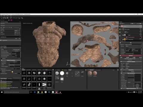

    And here a video about triplanar projection in Substance Painter:
    This solution needs some control maps to work. Those can be created in Substance Painter but that is not explained in the video. I don't know Armorpaint, so I can't say if triplanar projection is available there as well.

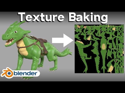

    Remember those procedural textures you can make in Blender3d without a single UV map that can be infinitely scaled, were seamless and can make all kinds of cool textures? Remember how they were only available in Blender so you forgot about them? Well those puppies were beefed up to be hella better and- they bake. That's right, just do a simple UV unwrap and no hand painting or seam matching required- texture baked right onto the mesh and ready to be saved as an image file so your blender models can be used in DAZ with their textures intact.
