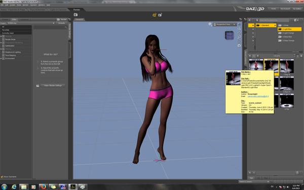

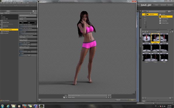

I am a COMPLETE and TOTAL world class NOOB. I have little experience with Daz Studio and I am kindly asking for a bit of help. If possible of course. I am trying to figure out what the hell am I doing wrong with rendering. No matter which light preset I use the rendered result willl always be the same. Meaning - rendered image will always show some default light preset and not the one I used. I am attaching a few pictures for a better understanding of my total lack of knowledge. One picture shows which light preset I used and the other how it actually turns after rendering. Well..not exactly after rendering, i don't wait that long but the image basically shows what I'm trying to say. I am not even sure if all this makes any sense at all. I apologise for that. O btw I did try moving and rotating lights but but the result was always the default light preset or something.

    This is rendered in DAZ Studio 4.8 and you are rendering with the Render Engine Iray. Probably your lighting mode is Sun & Sky. Might be the reason all your images look the same, the default Sunlight is coming always from the same side and angle.
    The light presets in the screenshots are made for 3Delight. Go to the Render Settings Tab and switch the Render Engine to 3Delight and you should get a diffrent render result.

    Ah! You are right!! Indeed I was using Iray engine and ended up with same results!! Thank you very very much!!! Like you said I changed it to 3Delight and it is indeed a different result now :) Sorry, Im just that dumb. Though I must admit the Iray render does look waaay better. Is there a way to change the light position so that it don't always come from the side like on the picture I posted in my first post? And if it can be done where do I do it? Once again thank you for your kind reply :D
