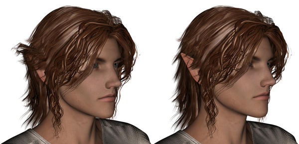

    You did the right thing, you have to locate the morph in the hair and dial it to 0%. I do not have the ancient combat hair, but I tried this with Elven hair on G2M and it worked. Left image shows G2M with Fae Ears at 100%, and as you can see the hair has followed his ears. Right image shows what it looked like after I clicked on the Elven Hair and dialed the greyed out Fae Ears morph to 0%.
    Thanks, that's what I was talking about. I read "cleared out the morphs to it" to mean deleted and I know something has to be there to say "0".
