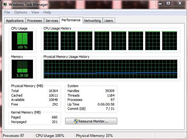

    Oh, I get it!
    Here is a snapshot of Performance under Windows Task Manager...
    Pretty much maxed everything out, by nothing is crashing.
    611 x 455 - 71K
  • HavosHavos Posts: 5,703
    Oh, I get it!
    Is that when rendering with one DS instance?

    The performance posted was for running two instances of Daz Studio, one is version 4.7 the other is 4.8 public build with both rendering at the same time.
    And both were using the 3Delight renderer.
    Will try Iray later, hopefully I can still have the public build version installed with the 4.8 release. Enjoying the best of both worlds right now.

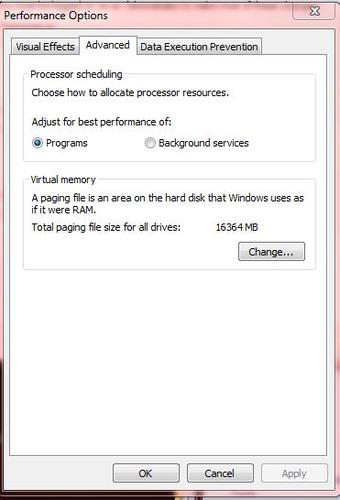

    I do have AMD CrossfireX enabled for better graphics performance, unless there is something I am not noticing here.
    Just found this, under my advanced settings for performance options, processor resources are allocated and adjusted for best performance of programs running. Maybe that's why?
    371 x 546 - 38K
    Post edited by provencial on
  • Richard HaseltineRichard Haseltine Posts: 111,382
    The Performance setting is standard, and crossfire has no relation to 3Delight - it's a purely GPU thing (and you won't get any benefit from it with Iray since that uses nVidia cards for GPU acceleration).

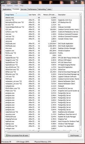

    Wouldn't it make more sense to show a screenshot of the processes? That would provide more info, as to resources and CPU usage, for those who are trying to make sense of it.
  • provencialprovencial Posts: 84
    Here is a screenshot of the processes...
    612 x 1038 - 175K
  • SimonJMSimonJM Posts: 6,100
    That shows what most people have been assuming - each of your DS processes is using about half of your CPU resources. In theory that means that 1 DS instance would run twice as fast as it is currently doing, meaning it should do the job in just about the same time as your current two instances. That's why people are confused and seem to be asking the same sort of questions!
    It would be interesting to see your performance when running your render in just one Daz Studio, as I would expect that to be using just 50% of CPU capacity given that your render is twice as fast when using two DS instances. If a single instance is also using 100% of cpu (and in normal circumstances a 3DL render would) then I am very confused to why your performance is doubled running with two instances of DS.
    OK, seems you guys were correct, I did a test with render times both rendering at the same time and individually and there was a 50% slow down on the render times.
    I think it seemed faster to me because 4.8 renders quicker than 4.7 - so that is why it seemed like it was faster.
    Awesome lesson to learn - thanks, I almost fooled myself on this one! :red:
    Gotta love how fast 4.8 renders!
