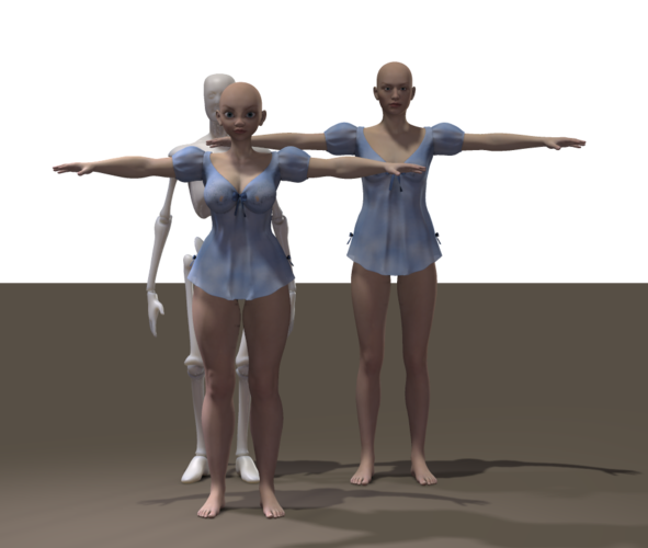

Have not been having trouble with Aiko6, Callie6, etc. But I just got Girl 6 and she merely is a stock G2F with Actor->Stylized->Girl 6 set to 1.0.
I have the latest PP 2104 10.0.5.28925 (I think this is SR 5.2) and the DSON Importer 1.1.3.50
I attached a base render (with default lights, Poser 'Andy', and Callie 6 to show something works). Girl 6 is the rear G2F, who obviously isn't girl 6!
I am mainly just curious if anyone has tried Girl 6, to indicate if this is likely a problem with my system or Girl 6. Is there any debug or log file created by the DSON importer. Girl 6 does seem to take longer than expected to import, so I am guessing some file is not being found, so is being searched for.
Thanks
958 x 810 - 245K
