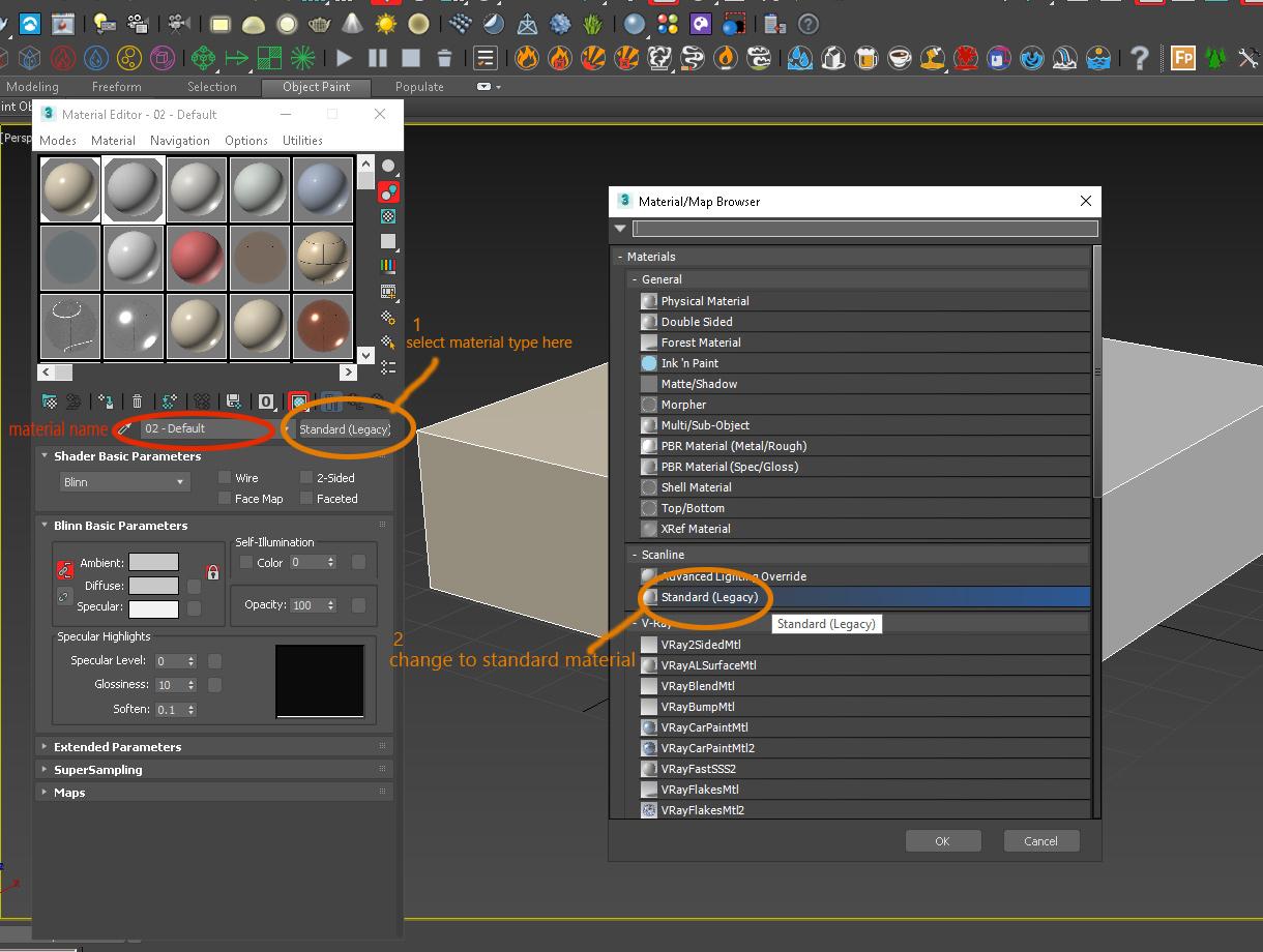

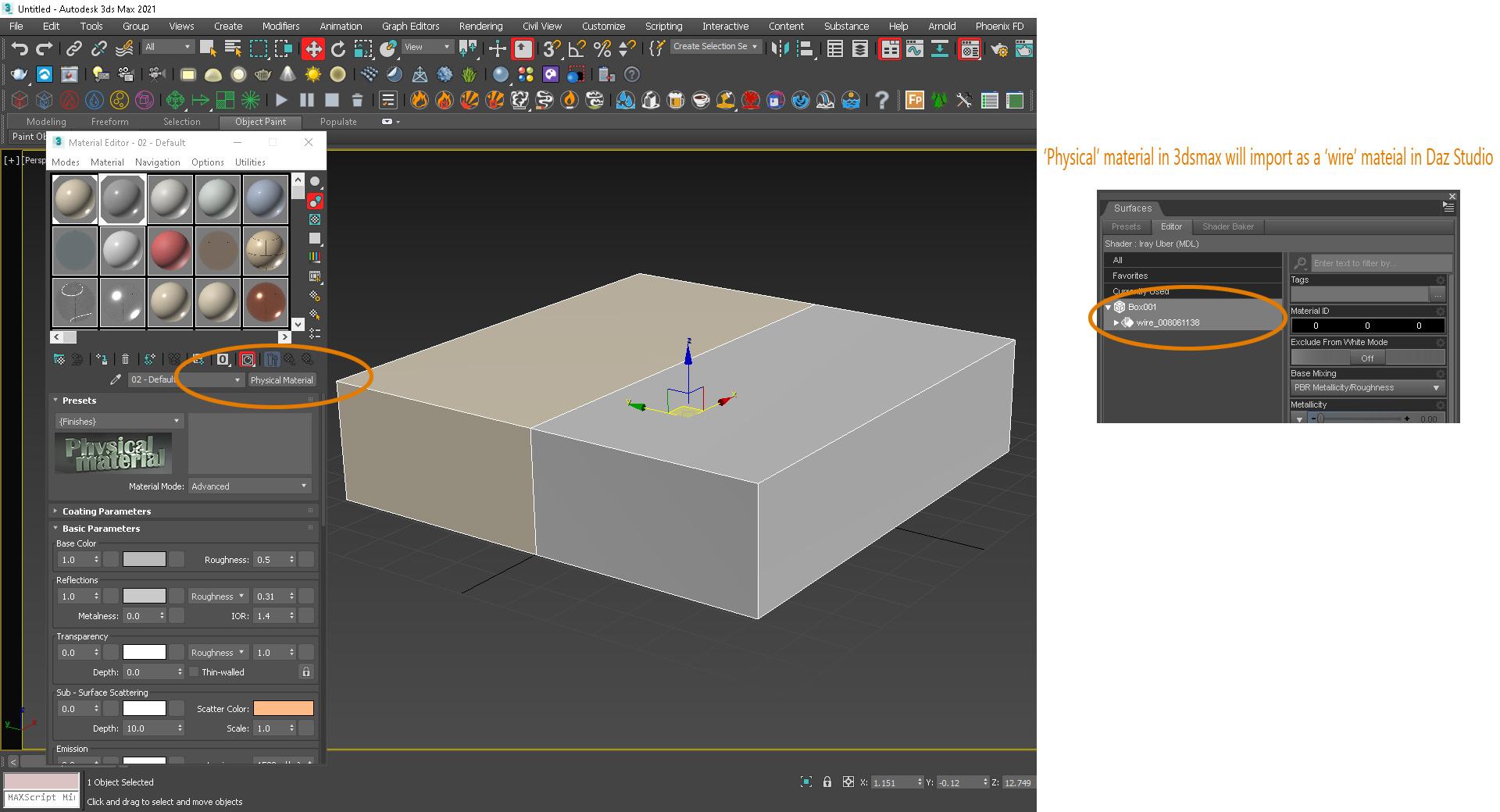

    hopefully these images can explain..I think the new default material in 3dsmax is the 'physical material', that as well as a vray material will condense all material to one on export to Daz Studio,
    the example in the first image is a cube with two materials,when exported to DS you can see the two materials become one,and is renamed 'wire....'
    second image shows how to change material type to the legacy default scanline material,

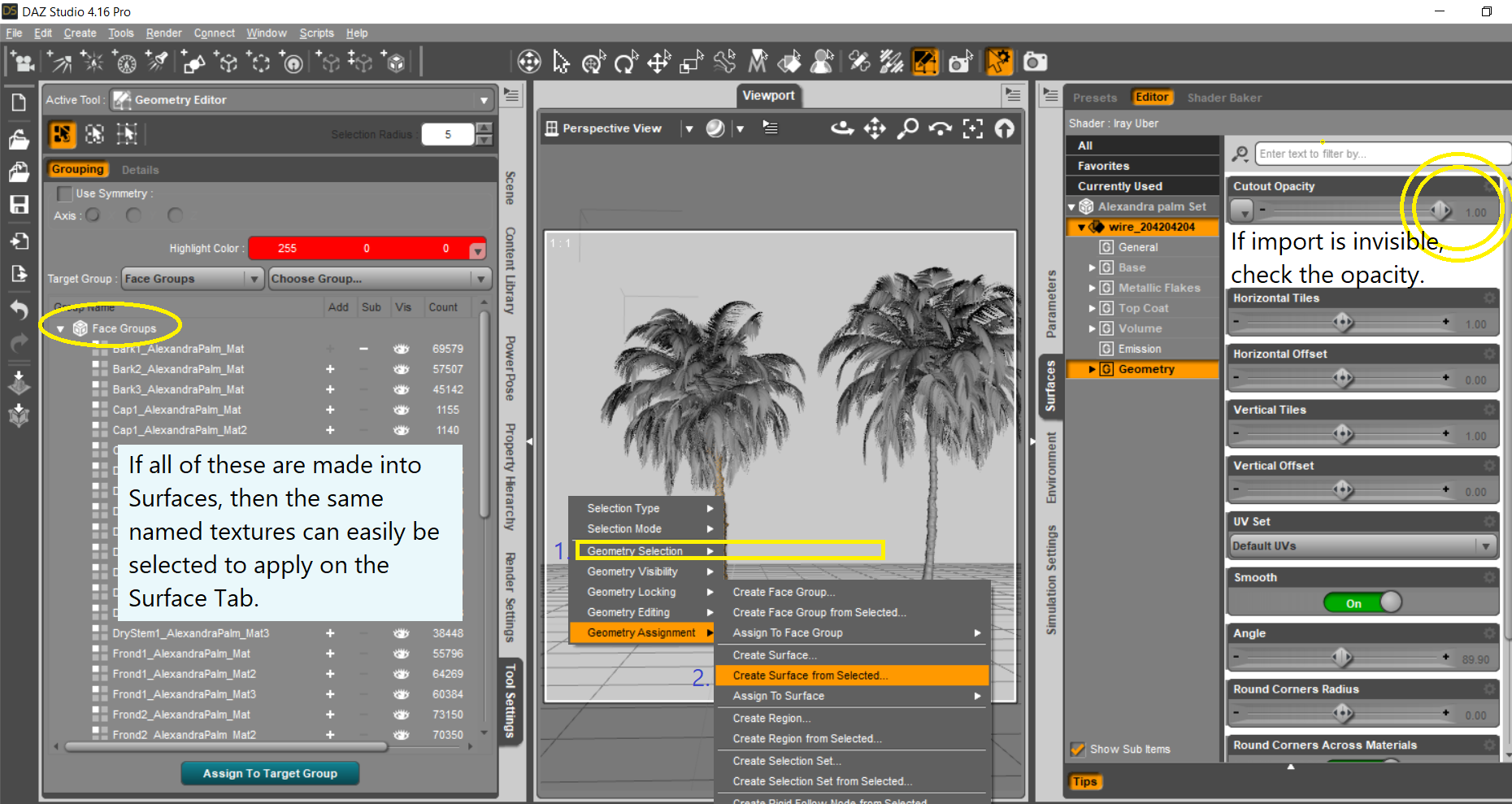

    And for those who have the wire material and don't have 3DMax, in D/S, IF the materials happened to have been written into the .obj file as they were for the file shown here, then using the Geometry Editor tools one can remake the surfaces, etc.
    n.b. the reason for culling down the number of groups is more important if one has any intentions to rig the model(s). Every Face Group will become a Bone.
    Also, just in case anybody recognizes where this model came from, do be aware that of the hundreds of trees sold, so far I've only found 2 such files - and they were from the older sections. 99% loaded just fine in D/S which is pretty decent.
