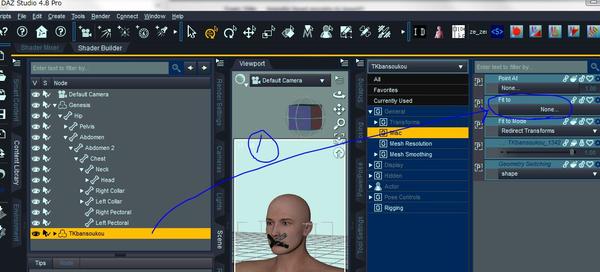

    if so,, select beard ,and set not "fit to" .
    it is important to auto transfer morphs again. if you keep bear fit to genesis.
    all latter steps not work. pic1

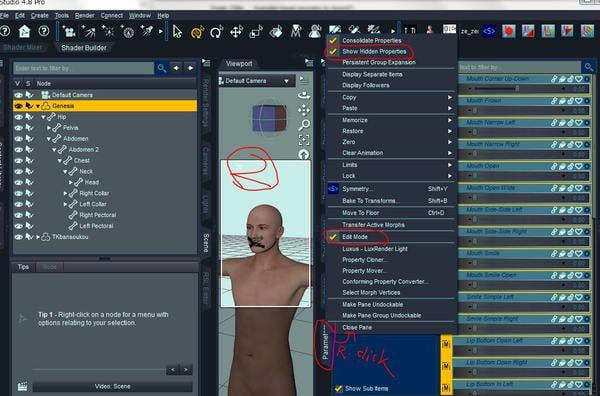

    then go to (or open) parameter tab, then change 2 options.
    a check on "show hidden properties"
    b check on "Edit mode" pic2

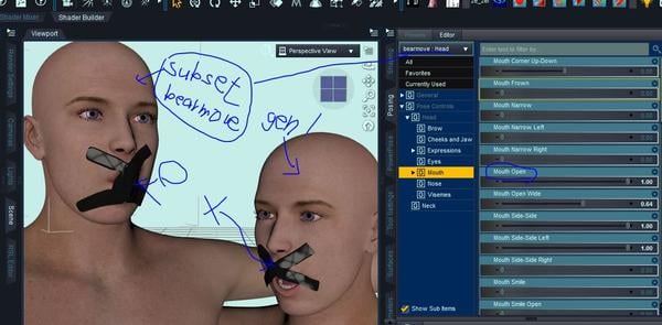

    this time, you need only pose controller, not hidden morphs,
    then select genesis "head" then go to pose controlls, open mouth etc,,,
    now your bear should follow these controllers. (if you set hidden morphs auto-follow correctly)
    I stick pic . one of non auto follow default genesist, the other is "auto follow on" gen subset.
    and use same cheap mouth tape (but it work,,,,)
    both actor mouse open, but now you can see, only subset genesis ,mouth tape auto follow the poze.
