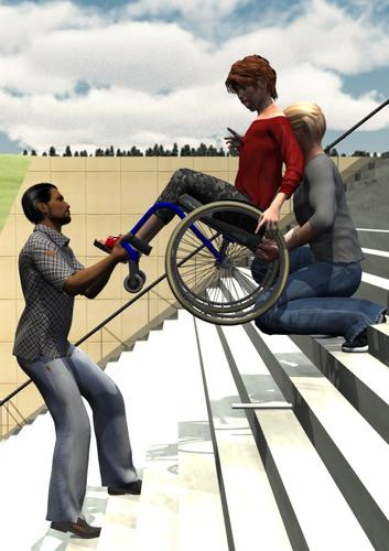

I've been working with a posing nightmare for the last week, 4 figures all interacting with each other, and in a tight physical environment. I think I've finally gotten the poses into something near to a final setup, but there's something niggling at me, and I'd appreciate a few other opinions:
Looking at the three adult figures alone and forgetting the child for the moment, does it look like the wheelchair is being lifted up the stairs, or down the stairs?
I was aiming for up, but I think it might be more convincing as down, in which case I can easily reverse the child's facing.
800 x 565 - 78K

    Raising the nearest person's right foot to the step above would certainly make it look more like they are going up the stairs. :)
    But the least convincing part I find is the position of the person furthest away. You simply wouldn't be crouching down and have your arms up like that. The weight of a person and a wheelchair would mean your arms had to be really feeling the strain and as such much straighter and hanging down. So you'd have you legs a lot straighter and be bent over at the waist with your shoulders really far forwards.
    Hope this helps a bit. :)
    Edited to add: Thinking about it, when people carry wheelchairs like this up stairs, they usually rest the back wheels against the stairs too so they can almost 'walk' the large wheels up the stairs. So it may help to have the furthest away person holding the handles of the chair the nearest person just lifting a bit for each step... hope this makes sense.

    I totally agree with Dave on those comments about the position of the figures. The hande side of the chair should be highest, whether going up or down a flight of stairs. When they carried himself down the stairs in a wheenchair, last time he was rushed to hospital the strongest person had the handles and was at the top, the assistant was guiding the bottom as they went down. They reversed when getting the chair up the steps in the front garden (dual level front garden) and pulled him up the steps backward.
    His left foot is already on the step above the right, I might change the aspect ratio away from pure portrait to get the feet in, but they actually seem to work with either direction of movement.
    The problem with that idea is that the only place you can actually grasp the frame to lift the chair is at seat level, there's no practical and safe way to reach that lifting point other than crouched if the chair is facing out from the stairs. If I reverse the chair, which does make it easier, then I lose the facial view of the female character, unless I reverse the camera position to the top of the stairs, and the sky view, with the Underground symbol, is an essential part of the composition.
    I take all your points, and thank you for them, but it's an active user chair with a low back and no push handles - which is fairly typical for long term wheelies - and I'm trying to present the difficulty the environment creates for people. As for bumping down the stairs, that really depends on what the user can tolerate in the way of impacts, I almost certainly couldn't tolerate it. Ideally you'd probably lift this with back out from the stairs, or from the side, but the width of the staircase makes the side carry impractical and I've already explained my reasons for not reversing the chair pose.
    Yes and tilted back, the principle is you should fall backwards into the stairs, rather than be tipped away from them. I suspect you're both more familiar with the high-backed style of wheelchair, but with an active user chair there is often no frame to grip above the actual seat level, which, combined with the need for a back-straight lift, is why the upper figure is in such a seemingly exaggerated squat. The overwhelming principle in this kind of situation is to check with the wheelchair user as to what they want done and how it should be done - a couple of friends have had their chairs damaged by over-enthusiastic helpers who wouldn't listen.

    Okay, another version of the render, changed to a square aspect ratio to show the feet of the lower character.
    Anyone have any thoughts on the original question of whether they're going up or down?
    800 x 800 - 97K
    Down I think

    Okay from a artist view toward the real this is what I get.... This one will always look like a down version. This is why, The man in the back would never be down like that or have his arms bent like that. He would be standing with a straight back and fully extending arms in the down position to carry all the weight of the lady and the chair that is on his arms. The man in front would be the one struggling to keep the weight from tipping to the front and causing an accident. That's from this view.
    Now if the man in back is trying to lift the bottom of the chair in a safe way to the top of the next step without damaging the chair I still think he would use the leverage of the wheels against the back of the step to ROLL the bottom up to the next level instead of a heavy dead lift as you are showing. That will mean a different pose for both men but I think it would look more realistic. I just can not buy into the "Lets Dead Weight Lift Her Up the Stairs." thing you are doing.
    If I had the chair I would do a quick example, but I do not. I do have a couple of Subway sets so that part is not a problem.

    Yes, I've moved a lot of people in wheelchairs and you'd want the large wheels on the step -- less weight to support, more stable, and gives the person in the chair more feel of being grounded

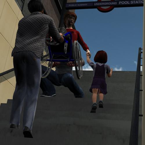

    Everyone: I don't want you to think I'm ignoring the advice saying rest the wheels on the stairs, but that's just not practical with this design of chair. I've moved the chair down to stair level and screen-grabbed an image, with the chair two steps in front of M5 (1 step isn't practical with it tilted back) the grab-rail at the back is level with his toes, and that is the highest lifting point at the rear of the chair. I don't know about you lot, but my arms certainly aren't long enough to lift from that level ;)
    I'm going to go with Cho's feeling, which matches mine, and rotate the child to face down the stairs on the assumption they're going down not up.
    531 x 814 - 117K

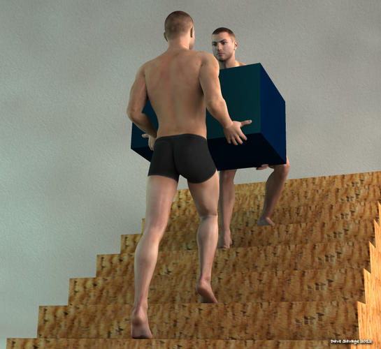

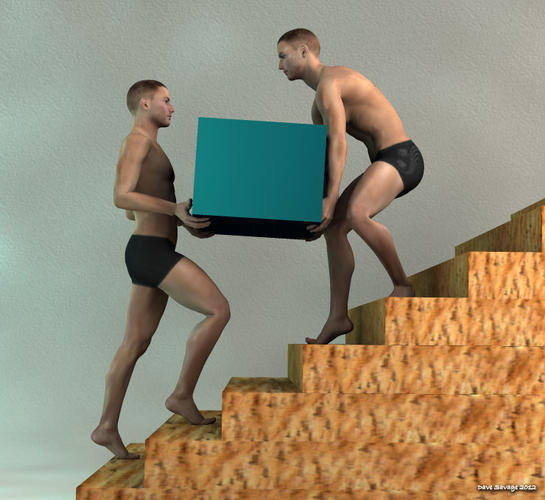

    Maybe this will help explain what I was saying previously.
    I have taken on board about the chair not having handles and altered these poses to reflect two people carrying something upstairs both grasping the bottom of the object. I've just used a box because it was simplest as I don't have a wheelchair prop, but the principle is the same.
    Notice how the two people use the most effective leverage that their limbs can easier manage and the person at the top has his shoulders really far forward to effectively extend his arms so he can still hold the bottom of the box without crouching down.
    Notice also that the guy at the top of the lift has one of his feet pointing sideways, this is the foot he always uses first to go up to the next step. He will lift his lower foot to the same step and then once again only move his left foot up another single step.
    The person at the bottom is taking most of the strain of the weight and has to have one leg really straight so will most likely do the same by lifting his left leg to the step above and keeping it straight while his right leg does all the lifting and bending.
    I've done it from three slightly different angles for a better view of the relative positions. Hope this helps a bit :-)

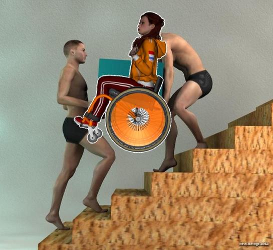

    I do see what you're trying to say, but what you've forgotten to account for is the occupant of the chair, which will make the rear of the box roughly twice as high, forcing the upper person back and away, and as he moves back, his shoulders will be forced away, and maintaining his grip with the fixed length of his arms will force him into a lower position with a deeper knee bend. At the same time the feet of the occupant, together with the footplate, lower front frame and the front castors will limit the positions where the lower person can grasp the chair and force him further away from the chair.
    I've taken a side view of the chair and user from my other image and superimposed them on your view to show the problem. The user has been scaled to have roughly the same torso height as the Michaels and tilted back 10 degrees, with the lifting point on the rear frame placed coincident with the bottom right corner of your cube. As you can see the users head and shoulders are in the same place the upper person's head and shoulders are, while her feet are projecting into the lower person's groin and the front casters are potentially sticking into his thighs - a wheelchair is a really awkward load, and the lift positions that work are not the same as the ideal lift positions for a box.
    Which might be applicable if the weight is distributed evenly, but by design almost all of the weight of the chair and occupant is aligned over the rear axle, putting the load on the upper person with the more awkward lifting position, hence the deep squat to allow his legs to do the work of lifting with his back straight and his arms locked rather than lifting.
    800 x 734 - 116K

    Yes, the girl in the wheelchair would be leaning further forward and the top lifter would be almost hanging over her shoulder.
    Mine is a much more realistic lifting pose for both the lifters which could be adapted suitably for whatever they were lifting.
    But there's no point me sitting and arguing about it with you. it's your render. :-)
