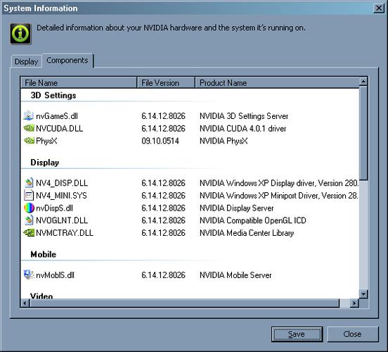

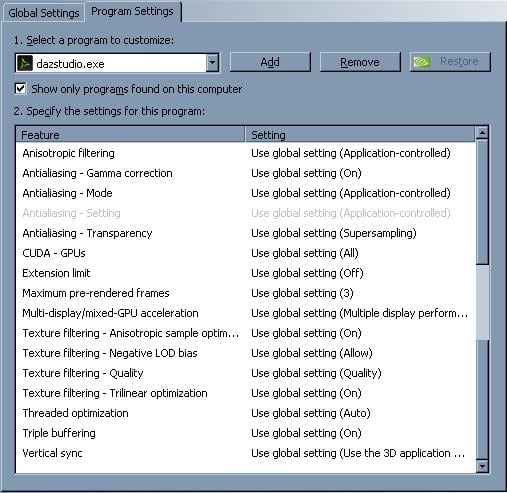

I may have more than one issue to resolve; not only are my cuda cores not showing up in the advanced tab, I can't even get a CPU only render (the render window never spawns and the process quits at 0.0 seconds)
There aren't any explicit errors in the log, so I'll just post some screenshots of all the settings and see if anyone has some ideas on what all I can try...
I've updated my drivers to 340.52 but still no joy. I would greatly appreciate any help you might be able to give me

    I think that the card doesn't work rendering with IRAY, because it just has 1GB of RAM. I have a 2GB RAM card, and that bows out verys quickly, as I also run my monitor with it. So it's basically CPU render for peeps like you and me.
    Does the "cut off" at 0.0 also happen when you uncheck "OptiX"?
    If yes, it's worth taking a look at the scene and light settings of the image you are trying to render.
    Could you post the render settings and the light settings?

    I suspect it's an XP 64 issue - 64-bit Windows XP had very limited take-up, and drivers for it may well be lacking in necessary features.

    Maybe the driver is too old. I had the same problem with a GeForce GTX 460 and driver version 337.88 under Windows 7 Professional x64. But there, only the GPU rendering has not worked, CPU only was no problem.
    By the way: Windows XP is officially no longer supported since April 2014 by many manufacturers, and the minimum requirement for DAZ Studio is Windows Vista. I recommend Windows 7.

    @Lee: I've tried with all settings checked and unchecked. Also tried just photoreal CPU and just interactive CPU with identical cut out results. I've tried to attach the file as requested, but the site blocks .DUF and .ZIP files so I don't know what to do...
    Can anyone confirm if this is an XP issue as opposed to a video card issue? I would consider upgrading my video card for IRAY
    Thank you all for your attention in this matter, your help is greatly appreciated

    If even no CPU-only mode works, then it's probably a XP problem.
    Remember: Windows XP is outdated and support has ended 2014 in April. And the minimum requirement for DAZ Studio is Windows Vista. Therefore I guess, Studio is also no longer tested with Windows XP, especially not completely new features like Iray. Maybe it works, maybe not. But as it seems, it doesn't work.
    I urgently advise you to upgrade your OS to Windows 7 or 8.
