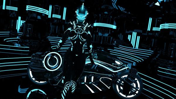

I can't get my emission lights to glow . With every render the light looks dim .
And I need some good skin settings for V4 . Can't seem to find any anywhere
1191 x 670 - 171K

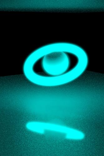

*edit* here's a torus as a light with bloom enabled and the settings messed with a bit. also the luminance value was 562668.31
