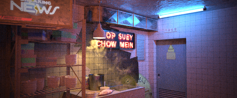

    I did this picture with Daz 4.16
    Notice the steam in front of the cook and on the right.
    Daz 3D
    Now this is Daz 4.20
    Daz 3D
    I skipped the steam on the right but kept the black tiles in the kitchen.

    I see it too in the 4.20 beta (4.20.1.34). The effect is caused by the refraction setting of the steam planes. Likely due to a change in the Iray renderer behavior when light interacts with opacity. You can fix it by selecting the steam planes and then setting the "refraction Weight" to zero (it is set to 0.1 by default). Adfter that adjustment it looks fine. See attached.
    Ciao
    TD
    For reference here is what looks like with the default settings:
    1600 x 667 - 2M
    800 x 333 - 657K
    Post edited by thd777 on
