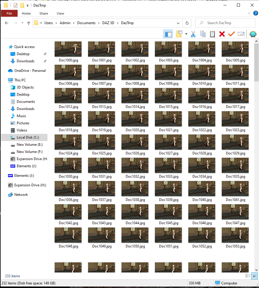

  • Bunyip02Bunyip02 Posts: 9,345
    edited May 2022
    Check your DazTemp folder to see if you have any large files listed.

  • Chris Fox ArtChris Fox Art Posts: 380
    there are 26 files with a .Compo ending. some of them have 4,7GB and  all together are about 34GB.
