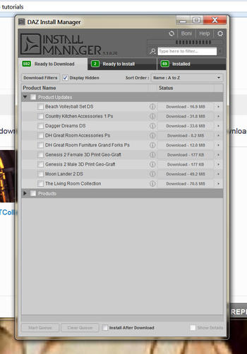

  • frank0314frank0314 Posts: 15,102
    Can you post a screenshot of your DIM downloads tab so we can see if something is off and hiding the download

  • boni_m_ab7b32f625boni_m_ab7b32f625 Posts: 113
    This is all there is in the updates.

  • BeeMKayBeeMKay Posts: 7,019
    edited May 2015
    There are still 2 downloads waiting for installation in "Ready to Install" in your screenshot... is it perhaps in there and not installed?
    Post edited by BeeMKay on
    Victoria 6 (which I already installed) and DSON which I've also installed.

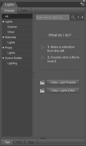

    I'm not seeing lights labeled anything like Iray or Nvidia. Downloaded 4.8 yesterday. And here is maybe a stupid question...do you have to have a Nvidia graphics card. Which I don't. You have my permission to LoL if you want. ;)
    Here is my lights window...
    Where in this listing do I find the lights. <------------- noob</p>
    332 x 562 - 22K
    Post edited by AnInnerEye on
  • SixDsSixDs Posts: 2,384
    No. You will be able to use DAZ Studio 4.8 the same as anyone else, with or without an Nvidia card. However, to use your GPU (processor on the graphics card) to complete any renders, you do need a CUDA-enabled Nvidia card. Otherwise Iray will simply default to your CPU. It will be slower to render, but it will work. Alternatively, you can still use 3Delight to render.
    As for your lights, you need to select one of the categories from the left pane for anything to show up in the right pane.
  • The Blurst of TimesThe Blurst of Times Posts: 2,410
    Where in this listing do I find the lights. <------------- noob</div>
    Lights. Okay...
    For me, my light buttons are at the top.
    Create a new Distant Light etc. Those buttons are to the right of the Save, Load, etc.
    You could also go to Create at the very top menus. All the same Light functions are in there.
    OR you could also create a "mesh" light. Take any object, and apply a light emitter surface to it, which is a little more involved than clicking on a Light button, but will add a ton of new tricks to your lighting.
    Lights are labelled the same as before, and load the same as before in 3Delight.
    But if you go to the Parameter settings of, for example, a point light, you will find at the bottom settings for "Luminence" and "Temperature".
    Luminence controls how bright your light is (a good start setting is around 45.000 units, except for distant lights, which work best between 10-15 units). Temperature controls the color of the light - the lower the temperature, the reddisher the light, the higher, the "bluisher". In the default setting, it's set to the color of bright daytime light.
  • AnInnerEyeAnInnerEye Posts: 23
    Thanks for the answer, slow I can handle. As far as the lights showing up I know that ;-) Just wanted to know if there was a particular category.
