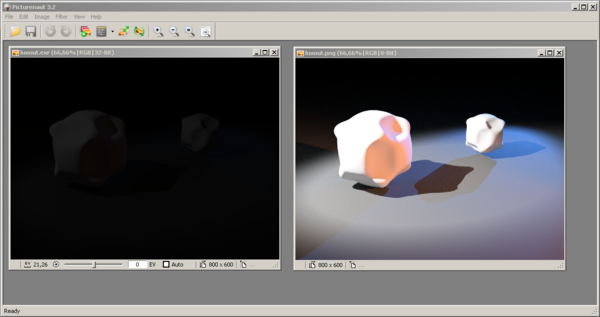

  • 3drendero3drendero Posts: 2,034
    edited May 2015
    The Luxrender plugin Luxus can save in the OpenEXR format and it is on 48% sale now:
    http://www.daz3d.com/luxus-for-carrara
    Free OpenEXR viewer: http://www.hdrlabs.com/picturenaut/
    Rendered one of the presets in Carrara and saved in in 32bit and 8bit in Luxrender:
    1190 x 628 - 503K
