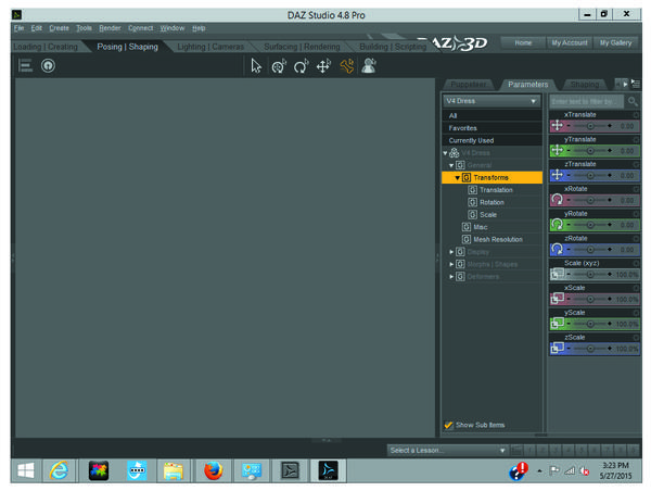

I need some help please. on both my Daz4.7 and 4.8 Beta the posing/shaping pane or window has gone blank and remains the same color as the margin, deep grey. My other windows or panes work. Lighting/Creating, Surfacing/Rendering, Building Scripting all seem OK. The first thing I checked was the tab to open the window or close it. I am an advanced user, I know you can pull or push the tiny tab to resize or 'fold away' a pane or window such as the Posing/Shaping window or pane, or even pull it out and go full screen. This has not helped me though. Am running Windows 8.1, 64bit, 16 gigs RAM, quad proc... It will still render, but it is very difficult to pose a figure without being able to see it in the posing pane.

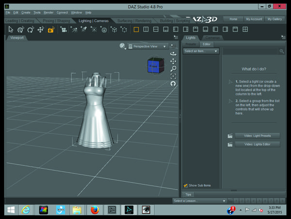

    OK, here are two screen shots. I just tried to delete and reinstall DAZ, this time the new 4.8 PRO. Note that the problem has occurred on Daz 4.7, Daz 4..8 Beta and Daz 4.8 Pro. Same exact symptoms. Any ideas please!
    1055 x 794 - 491K
    1055 x 794 - 391K
  • Richard HaseltineRichard Haseltine Posts: 111,745
    You have parameters in the Parameters pane and not in the Lights pane because it isn't a light you have selected. Your second screen-shot shows the Lighting activity tab, so it isn't set up for posing figures.
  • NormNorm Posts: 71

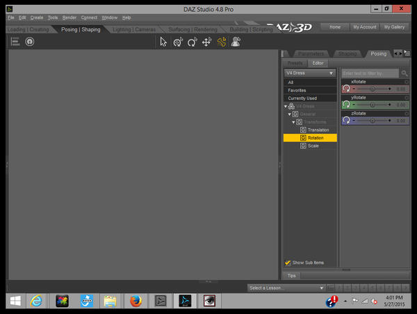

    Thank you Richard, but I don't understand what you mean. In the image with the screen in the perameters tab it should show the dress. Notice that I have no lights added to this scene anyway. The dress shows up in every tab except Posing/Shading. It should show up.
    1052 x 793 - 273K
    Notice that it doesn't show in the Poser/Shaping with the 'posing' sub tab (far right) selected either.
    1052 x 793 - 171K

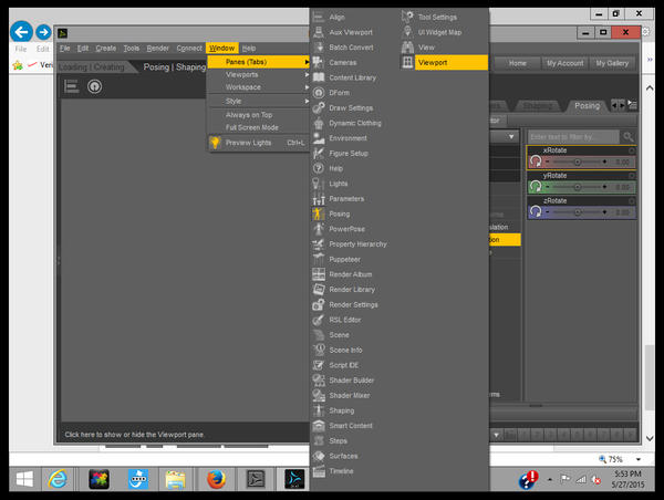

    Under your Posing and Shaping tab, you do NOT have a Viewport
    With Posing and Shaping selected, go to Window > Panes (Tabs) > Viewport, and that will get you a new Viewport pane. Drag it to the top of the grey part of the window, and when you see a yellow line, drop it.
    Thanks Jimmy, but that is one of the first things I tried. When I do so I never get a new viewport pane which I can not drag anywhere..

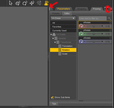

    It looks to me like your Viewport pane is in the group with the Parameters, Shaping and Posing. Click on the little right arrow as shown in the image below, and I think the Viewport is at that end of the tabs.
    Just drag it into the right place. If that is not the answer, I cannot understand why another Viewport would not appear, it can only be because one is already there :)
    SUCCESS !! :cheese:
    Jimmy C., It finally worked.
    I got a semi-minimized box first correctly displaying Posing/shaping. It was perhaps 1.5 inches square. I was able to enlarge it and finally it magnetically popped into the correct pane, filling it normally.

  • I'm actually having the same issue, but I followed the instructions above; furthermore, curiously, the viewport says it's on (turning it off and on did not fix things, as show on image one.)  Pasting the images below; images 2 shows drawers pulled out to show that I looked there first.
    1600 x 900 - 147K
    1600 x 900 - 119K
  • Update: had to shut off all the viewports in every task section, restart Daz Studio, and readd the viewports; that did it. However, based on that, I reported it as a bug. Thanks for the help, however!
