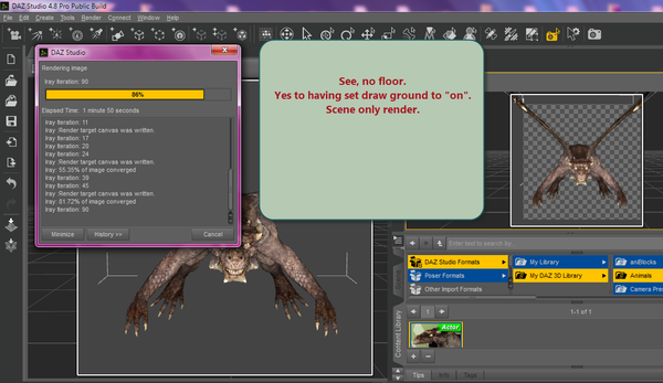

    It was "on", but it did not render!
    Edit to add pic.
    View mode sphere? .... hmm ... where's that?
    1172 x 677 - 219K

    Sorry, I browsed through a lot of pages and can't find the post. Somebody said they found and showed a render of, if I recall correctly, something along the lines of a robotic winged thing. That's what I was looking for.
    edit: okay ... I had made sure the ground was turned on but apparently one of the light options I then added was turning it off.
    However when I put it back on and removed the checker plane, still that magic ground did not look like it was going to appear.
    Somebody else I think calls it a shadow catcher?
    Anyway, 5 hours or whatever it would take for a spot render ain't happening. ? happened to the speed.
    I know I turned it to scene only. Anyway, what I did get rendered last night looked very good considering the age of the product so still am happy to see this new render engine and hopefully one day I'll get it all figured out.

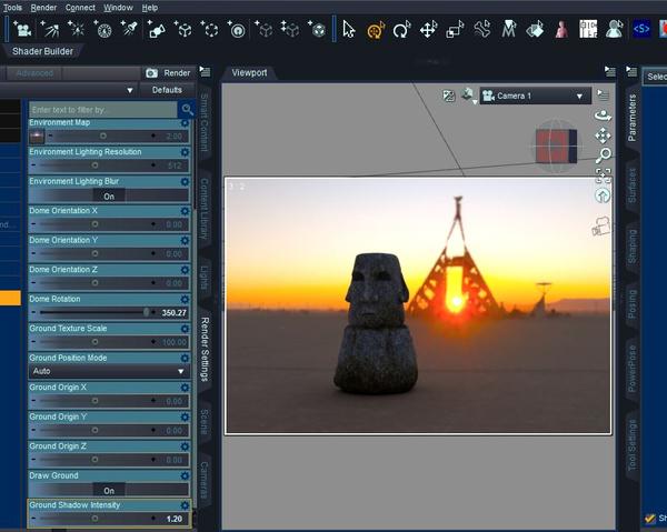

    it is good news,, now daz offer enviroment mode document about each options already ^^
    http://docs.daz3d.com/doku.php/public/software/dazstudio/4/referenceguide/interface/panes/render_settings/engine/nvidia_iray/environment/start
    I do not remember clear about each beta 4.7 (apdated frequently)
    anyway, now about 4.8, DS iray ground plane work with other setting of Enviroments.
    To just see clear "gorund" (can show shadow)
    set Enviroment mode =sunsky only, then draw ground ON = cast shadow.
    now you can see grey color ground.
    then tweak shadow intensity, or gorund color etc,,
    (I hope if I can add texture for ground,,,but it seems not,,
    then I need to use enviroment texture which include ground, and set draw ground "on",
    it can cast shadow,, (may need to adjust the invisible ground plane fit to enviroment texture ground)
    I play with changing each setting options, (enviroment mode, Dome mode, and Draw ground etc,)
    there have many variety .
    (But I really hope DAZ must fill many WIP documents .not stop their work. no need "daz time" or "daz soon"
    about document.
    now ds 4.8 is not beta version.
    and DAZ need to fill about 3delight render setting too. no need to say user,, serch old wiki ,they are almost same etc,,
