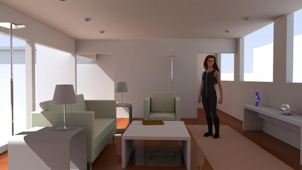

Here's a render. Originally assembled in C6 Pro. This was a minute and a half faster in C8 than C6, most notable is the precalculating lighting. I also think the lighting model in C8 is slightly superior especially around the edges. Same settings between the 2.
That looks pretty good!
Thanks, but I can't claim any of it.
Stock Carrara scene.
Various shaders replaced throughout scene with stock shaders.
Vicky 3 & some poserworld clothes.

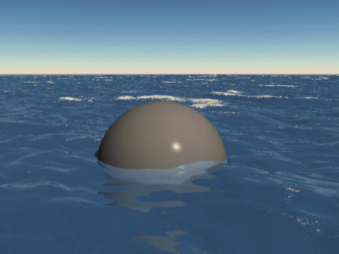

If interested, I created a shader for Carrara's Ocean primitive that uses a snow/elevation function to create white caps. Since the ocean is animated it appears and disappears with the waves. It can be used on a static object, such as a terrain used for a rough body of water.
https://www.dropbox.com/s/uw6y5yaplcf90zf/Water_scene_and_shader.zip?dl=0
That is some good looking water. Thanks for the download. :)
