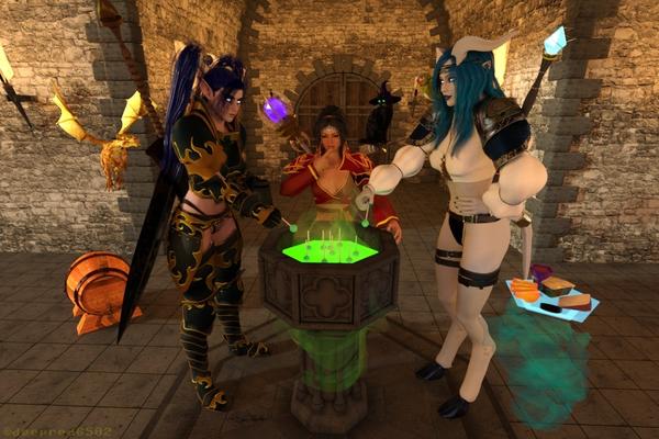

    Thanks for the advice. Here's the end result, which took 2 hours to render.
    "Warlock Candy" (also viewable at Rendo & DeviantArt)
