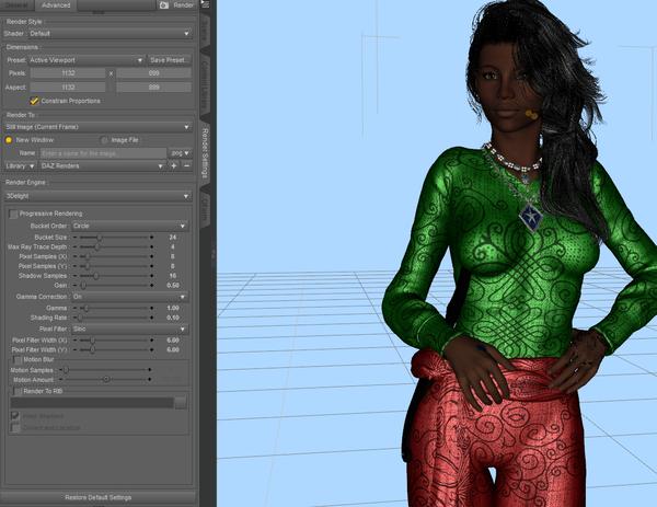

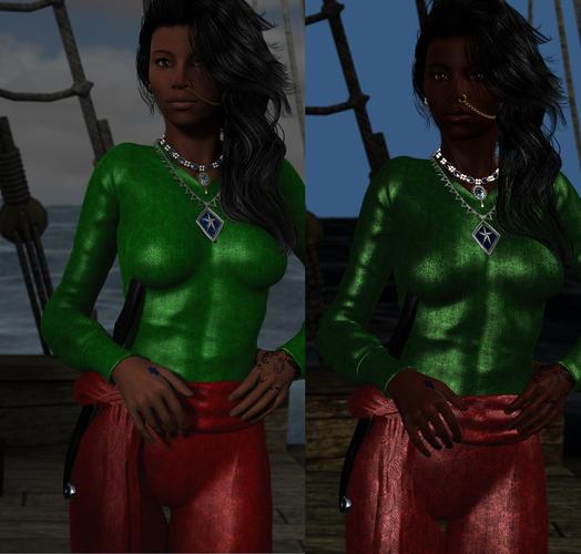

I've tried ev3erything I can to lighten up this scene, to the extreme of setting two distant lights as bright as possible (which you can see below on the right). The lefti mage is using a mix of shadow and diffuse and ambient lighting. No matter what I do, this scene remains ridiculously dark! To say this is frustrating is an understatement. I have deleted all lights, tried using just one, or three, with and without Uber, etc... nothing lights this scene properly.
All I can think is that, somehow, a shader I am using is somehow causing a lighting error in the rest of the scene. This isn't the first time I have had this problem.
I am using Gemologica shaders as well as Eva Silk Shaders, and DzFire's RealMetal shaders.
Please, if anyone knows how to fix this I really would appreciate it.
908 x 867 - 431K

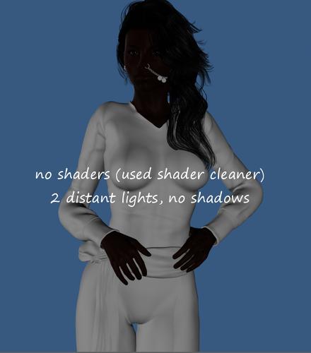

    Now, here is a scene rendered again--with ONLY Genesis and her clothing and jewelry. All shaders removed, no skydome, nothing. Just 2 distant lights with no shadows. This "scene" should be blindingly bright!!
    Also, I am not using any special settings on her skin. It's default Genesis settings. Lastly, there is no rendering error at all.
    798 x 906 - 158K

    Okay so I screencapped my render settings. Now please understand I almost NEVER play with any of these, except the Shading Rate. So while I have had this problem before, again I don't know why. I rendered a picture last night with this character just fine (http://drowelfmorwen.deviantart.com/art/Atha-an-Miere-Windfinder-535051094), with lighting appropriate. It's a sunset. But when I went to render a "daylight" version, that's when everything decided to mess up. I did not change any render settings except the size of the picture.

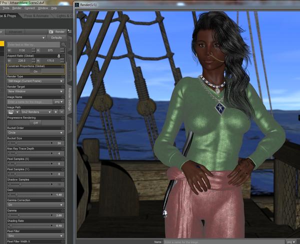

    Quick reply: I downloaded 4.7 and oh no (since I think I can't swear here, that's putting it politely)!! They totally changed the render pane!!! How in the Nine Hells are we supposed to render? Every little part must be clicked? That's a royal pain in the... ANYWAY, how do I change it back to its traditional nice advanced box like above?!
    Edit: Also, it didn't work. Render is still turning out almost black all around.

    You have gamma correction On, but a gamma value of 1.0. This setting gives you a linear image, appropriate for post-processing in e.g. photoshop or so, but not for directly displaying the render on screen. Set the gamma to 2.2 for this.

    With Gain at 1, but Gamma set at 1.2, it turned out... okay. Her skin and other stuff renders deep and colorful, but the silk shaders now look pale and totally off.
    So, still not Solved. It just doesn't explain what the problem is/was--it's not the settings, something is just wrong with this scene, and I don't know what. As a test, I opened up a totally different scene, with the same render settings (my original settings), and it rendered just beautifully as before. So I still don't know why this one scene was affected--and it'd be nice to figure out what the problem is/was.
    Below, other setting: Gain 1.2, Gamma 2. Silks... still not good.
    1162 x 946 - 560K
