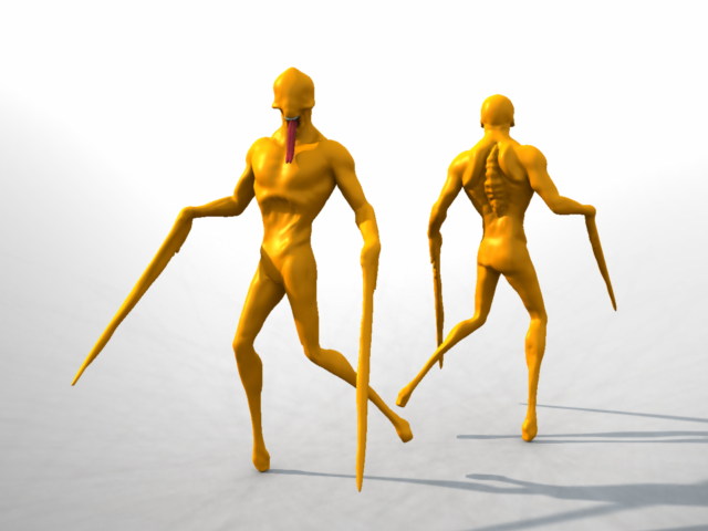

    I know it probably doesn't help but I did this in Carrara in just a few minutes... so a morph should be able to be done via Hexagon easily enough yes
    and just in case,,,,
    640 x 480 - 147K
    640 x 480 - 145K
