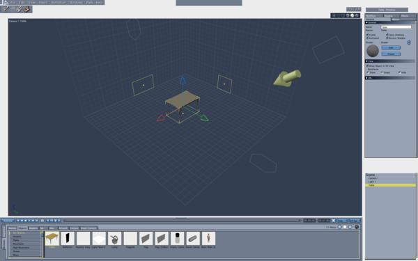

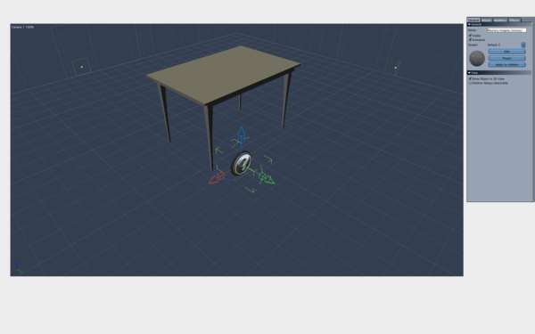

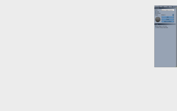

Is anyone using a Mac to run Carrara, and having a problem where you click on the screen and parts of the screen flash white as the menus, UI, or screen are redrawn?
What's more, sometimes it's just a flicker, and other times, well, let's just say I had the time to take these screenshots.

    I took Carrara out of full screen mode to check it. Turns out, for instance, I could get the screen to flicker pretty reliably by using the scroll wheel to zoom in and out.
