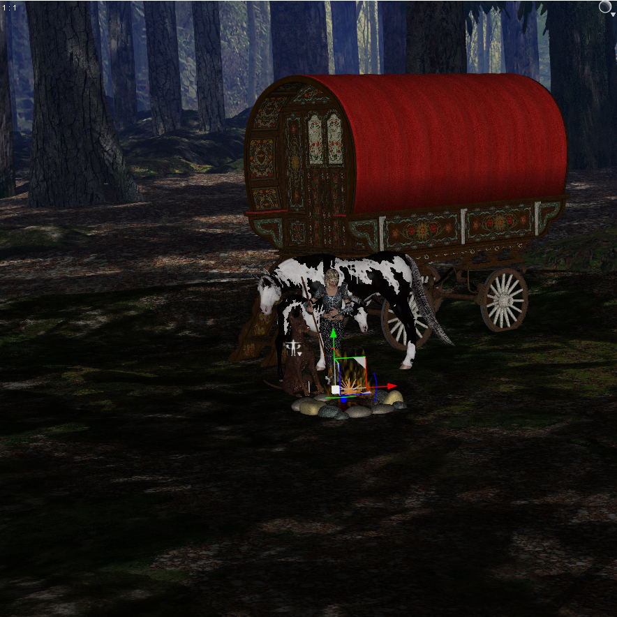

    I know this is an older Post, but I just happen to have run into this this weekend and I found this thread while looking for a solution.
    Bejaymac's Process will work for Genesis because it has a Consistent GUID (Global Unique ID), but it won't work for anything Pre-Genesis.
    All those who say, "Smart Content is Useless. I Never Use it. I dont want it."  Well here is a place where the Foundation of Smart Content helps you.
    Before Smart Content, the GUID wasn't Gobal it was Local and handed out to an Asset when you saved a scene in Studio (well Actually Loaded the Asset, but Saving wrote it out to the Disk). Thing is the LUID was Unique ONLY to your system. if you had two Computers they each had their Own LUID for Victoria 4, therefore I couldn't start a project on Bill's computer and finish in on Sally's. With the addition of Smart Content, GUID's are actually Global and everyone has the Same GUID all Daz 3D Content. Therefore I can hand John a scene File and if he has all the Assets, he will be able to load the Scene. (This is what makes Redy To Render files work.)
    So here is how StratDragon get that Pre-Genesis Scene back, and Make it so he can share the Scene file with a partner.
    First you load the broken scene, and as Bejaymac said you won't see anything save Boundary Boxes.
    It will most likely look something like this:
    Now to Rebuild it and this is a lot of tedious work:

    NOTE: with Genesis, you have to be careful because some of the Skin Materials are actually from V4 and they won't reload properly, (Or that has been my experience)
    In the end you should have your Scene back. In my case, all of the mess above resolved into this.
    The Advantage of this method, is that you will have a Scene which uses the assets with the new GUID's.
    In my scene the Fire and the Staff were an issue and I had to replace them, because I couldn't find the Originals.
    This took me about twenty minutes to Rebuild and most of that was finding the Fire and Staff.
    Also selecting the missing item and going to Smart Content tab with Products select, made getting to the content much quicker.
    Hope that helps.
