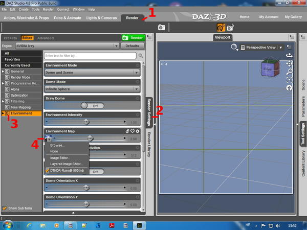

Iray daz 4.8 beta new guy need help with HDRIs I can't find a good tutorial for iray
Can anyone show how to use an hdri properly for iray in daz 4.8? I can't seem to figure it out. Thanks!
  • ben98120000ben98120000 Posts: 469
    edited May 2015
    1. Click on Render tab
    2. Click on Render Settings tab
    3. Click on Environment menu (make sure that Editor is active in upper part of the tab)
    4. Click on the little box on the left of the Environment Map field to get a menu, select Browse and navigate to .hdr map you wish to use.
    If you wish to render your .hdr image (that the picture is visible in render) set Draw Dome option to On.
    1024 x 768 - 280K
    Post edited by ben98120000 on
