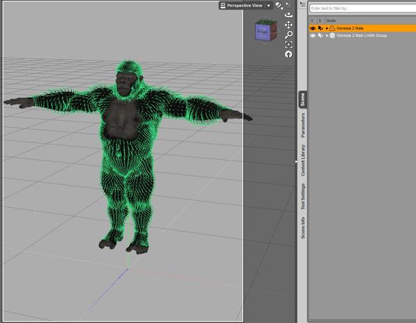

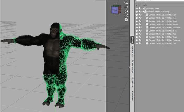

    What happens when you load one of the duf files? Does the Gorilla appear in the viewport at all?
    In theory, you should see the gorilla figure with bright green guide-hairs sticking out from the skin. Only when you render are these guide hairs converted to the fluffy fur you see in the promo pictures. I've shown the initial load state I get, and another image showing a spot-rendered part.
    If you are getting something different in your viewport, could you give a screen print please?
    1157 x 705 - 95K
    1153 x 894 - 110K

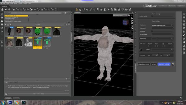

  • fred mertzfred mertz Posts: 25
    How frustrating to see it is working for you. I was a master of Daz3 but I am a dolt in Daz 4. The program is SO hard to get working properly.
    This is what I see when I load the duf file.
    1920 x 1080 - 635K
    Ah, I didn't try the Albino version, only the other one - it's just possible that there's a difference. I'm out on my laptop at present (no DAZ Studio there) so won't be able to try the Albino Gorilla for a while. I imagine you have tried both though? (If not, please try the other Actor).
