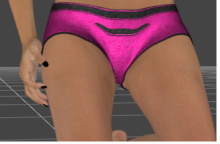

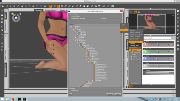

    Tried it. If I check all the modifications box, I get a full body pose . If I don't , I get same old problems. Here are some shot's , maybe this will help in clarifying this mess :) First image is with the actual pose I want to save... as you can see , the nails are just about to touch the skin. Second one is when I'm saving the pose, selecting nodes and checking the ' modifications ' box . third one is the actual result I get when loading that pose, on same character from a upright standing pose . Hope someone can teach me how to it properly :)

    I've sorted it . I'll post how , maybe it will help someone else . So , first select the hand , or foot using the Active Pose Tool and pin it in place ( press Space bar ). After that go to save - Save as - Save pose and in the tree selection select ALL THE NODES THAT YOU THINK CAN HAVE ANY INFLUENCE over the arm / foot pose that you want to save. In my case, the pictures above , I selected from the hand itself all the way to abdomen 2 ( had to bend it a bit forward to get the pose for the hand ) . Don't check the ' CHECK ALL MODIFICATIONS @ BOX ( Doing that will give you a pose for the whole body ) . save , and load . It worked for me :)
