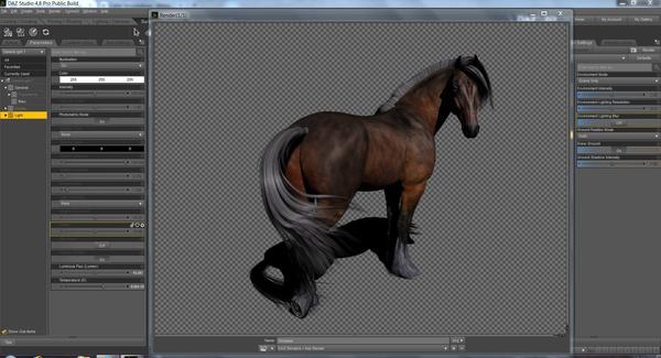

Iray; 2500x1200 CPU Only 2 days 13 hours 3.6% converged on Current Model Imac Desktop
However, I can't see any difference to how it looked after 7 hours overnight

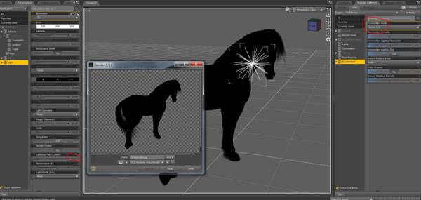

Changing the intensity changes the light in the 3d screen, changing the Luminous Flux changes it in the render!
Works with distant lights, but Point Lights don't seem to light the render at all.

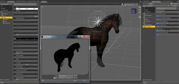

I am not using sun, I have 3 distant lights switched off and then created a point light to see how it works, - it seems not to work at all.
What strength are you using for the lights? Normally, it should be at least 50.000 to see a result.
EDIT: Sorry for asking something stupid, but you have downloaded the Iray lights for 4.8, and are using them, not some other lights like AOA lights?
At this moment i am getting what looks like a brightly lit render using 1 distant light on 900 lumens.
You are suggesting that a point light would need a much higher setting?
EDIT I am using the point light at the top of the screne under CREATE, I switch the photometrics on, is this wrong?
Distant light needs a much lower lumen, like, 10 or 20 max.
Point light needs higher lumen. I'll but some examples together in a minute.

I am rather confused by this information as it seems, on the face of it, illogical, and it never occurred to me that where a couple of hundred lumens of distant light would suffice, I should try millions of lumens when using a point light, however I can cope with that.
How do I get the point light to illuminate the 3d screen?
Okay... a point light is similar to a candle.
Also, you probably have the default HDRI background light giving you some basic lighting.
Make sure that in Camera, under "Parameter", the headlamp is set to "Off". Default is Auto.

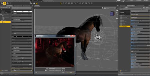

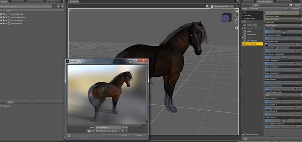

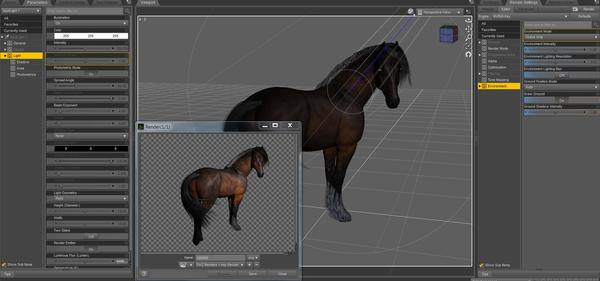

Here are two examples of Point light. Please look at the render settings at the right side of the screen.
The first image is Default, at 1500 lms, no other light source.
The second has the point light cranked up to 500.000 lms.

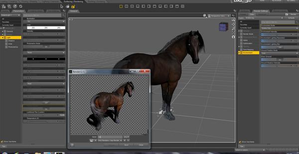

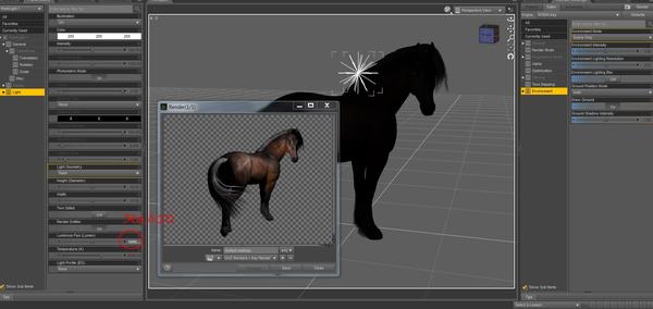

The next pait is a linear point light. They are basically the same as a point light, but you can adjust certain features in them.
Again, one render at default, one at 500.000lms
What you always have to keep in mind is that in Iray, light behaves like normal light, so it will decay with distance. If you want to lit something far away, you need a stronger light.

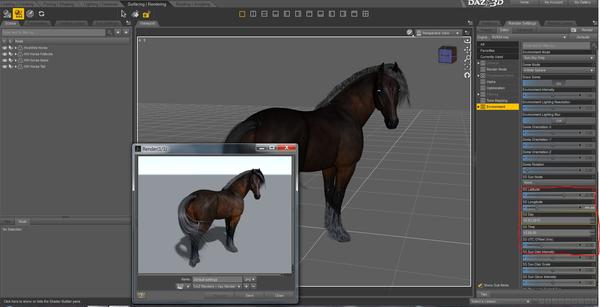

okay... for sunlight, you do not need any additional lights in DS for Iray.
First, delete any lights you have in your scene. You can always add more lights later, but for learning, we just use the sunlight from Sun-Sky

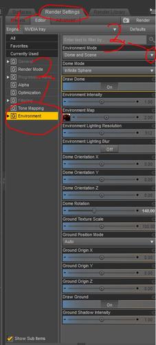

Now, locate the "Render Settings" tab (marked with 1 in my picture). Your layout is probably different from mine, but the lavels are the same.
Then, select "Environment" from the list (2).
Click on the small triangle next to "Dome and Scene" in Environment Mode (3).

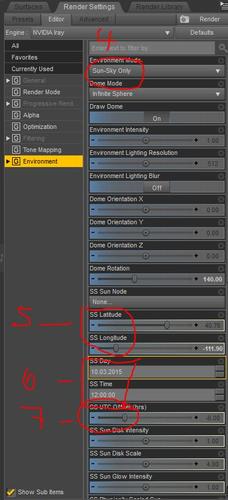

Select "Sun-Sky Only" as Environment Mode (4).
You can leave most of the settings at default for this first test, but I will quickly explain the most important settings.
First, there is the SS Latitude and Longitude (5). You can adjust the sunlight as it would be for any location on earth with this. Default setting is for Salt Lake City, which is where DAZ3D is located. You can find latitude and longitude information in Wikipedia, btw.
Second, is the SS date and time (6). You can simulate any time of the day during any day of the years with it.
However, if you use this setting, be aware of SS UTC offset (7), which tell the system how the time you set correlates with universal standard time (that's London winter time zone). Default is UTC -6 , the time zone which contains Salt Lake City.
I suggest that you start rendering with the default settings at first. Then, I recommend you try playing around with the time of the day, to see how the light angle changes. Oh, and for test renders, chose a smaller image size first, like 700x500.

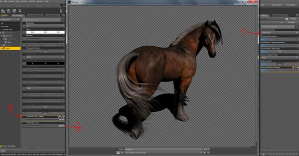

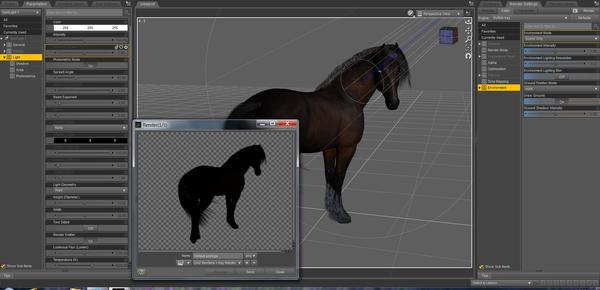

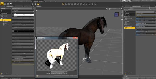

You can also use the distant light if you don't want to use sun-sky.
Select either Dome-Scene or Scene Only (marked with 1 in the image).
Then, add the distant light.
Select the distant light, and turn down luminescene to 5-15 (see mark 2).
Yu can change the "sunlightcolor" by changing the temperature (see mark 3).
Here's an explanation about the color temperatur, with color chart: http://en.wikipedia.org/wiki/Color_temperature
