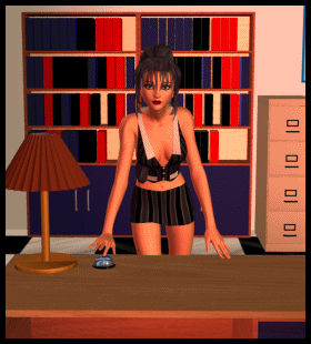

soon ( before June ) - mcjReach - Pose helper script
mCasualmCasual Posts: 4,607
edited May 2015 in Freebies
you select a target, for example a null node at the surface of a desk
you select a targeter, for example Amy's right index finger
you select the actor, for example Amy's abdomen joint
from the list of 6 transform properties, you select one, for example the Bend property
click the Go button
quicker tan the eye can see, mcjReach will try 30 bend angles for the Abdomen
( 3 degrees smaller to 3 degrees greater than the current bend angle )
it will set the Abdomen angle to the angle that minimizes the distance between the targeter and the target
you can then repeat the process with the hip, chest, shoulder, forearm etc etc until the target is reached
800 x 450 - 186K
280 x 310 - 348K
1080 x 1080 - 427K
Post edited by mCasual on
