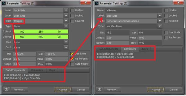

    Thanks for the feedback! Here is an example of what I was wondering. In the picture, Littlefox made a morph that controls some other dials.
    I was curious how these ERC Delta Add's are done? (which is where I was going to look to try and tie it to a surface property)
    801 x 416 - 92K

    The simplest way to create ERC links between item parameters is to put the parameters pane into edit mode, by right-click in the pane, then drag one or more properties from there into the Sub-Components or Controllers group under another in the Property hierarchy pane.
