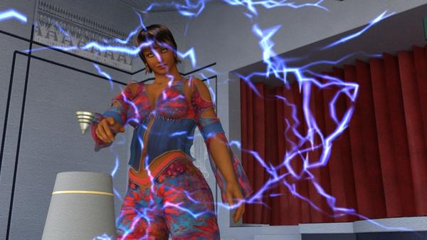

    Thank you SickleYield for your helpful reply. I tried your suggestions but alas they only resulted in partial success. Obviously there is more or I'm still doing something wrong. I've attached an image I made using iRay for the background and 3Delight for the lightning bolt in the foreground then added the two (separate) images together in good old Paint Shop Pro. You can see the effect I'm trying to get, the subtle shadows of iRay (or Reality) and the smeared effect of 3Delight. My goal is to achieve the whole thing in iRay or Reality because even 'though lightning is producing lots of light, there are also shadows if other (external) lights are present. Can you please help me with this or at least direct me to the appropriate literature. So far all I've managed to read is a lot of irrelevant text.
    Thanks
    Allan A.

  • SickleYieldSickleYield Posts: 7,649
    Check that your camera headlamp is off in parameters?
  • allan_2239099allan_2239099 Posts: 2
    Yep! That's usually the first thing I check. I'm pretty confident that only the lights I want on are on.
