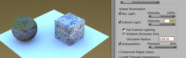

    I have AoA, and the Carrara equivalent would likely be...
    Typical Assembly room setting, delete default Light 1 from the scene to get rid of shadow.
    You'll need a simple "omni" light source. 3 choices:
    Assembly room, Scene Effects:
    - Atmosphere: Realistic Sky
    - Background: Bi Gradient, or, Color
    Personally I prefer the bi gradient, seems faster, and softer too. The default color setting is fine.
    Then go to Render room: Global Illumination: turn Skylight on, Indirect Light on, and select Ambient Occlusion only. Ignore everything else. Voila.
    For further adjustment of AO "shadow" intensity, either play with Sky Light + Indirect Light dials, or via Scene: Effect: Ambient brightness.
    Shoudl fetch fast and easy AoA-ish result.
