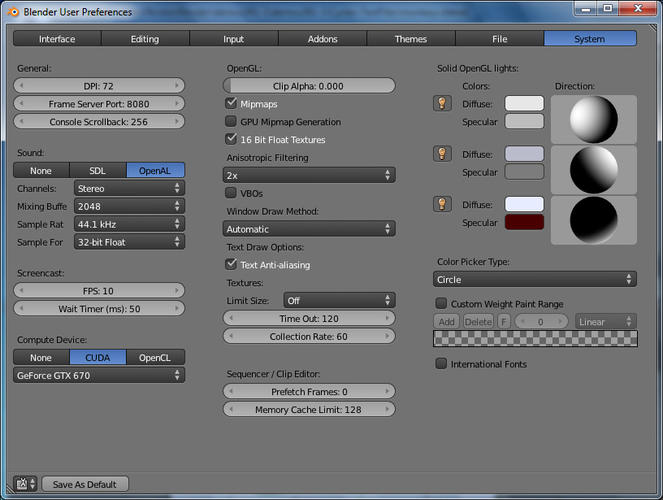

  • ArtiniArtini Posts: 10,920
    To be allowed to use GPU rendering in Blender one need to change a setting
    in user preferences "System" tab, "Compute Device" to "CUDA"
    when using Cuda supported Nvidia graphic card.

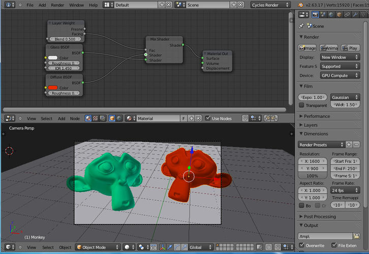

    While performing tests I have opened in Blender the file
    monkeys.blend from the folder demos261-1->Cycles-TestFiles
    and changed in "Render" "Display" to "New Window"
    In "Device" field one can choose "GPU Compute" or "CPU".
    Press F12 key to start a rendering.

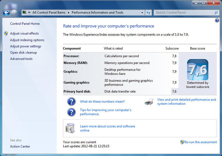

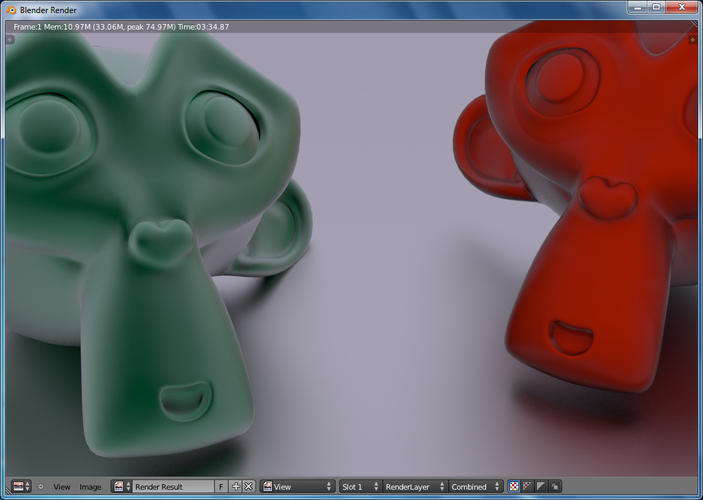

    edited August 2012

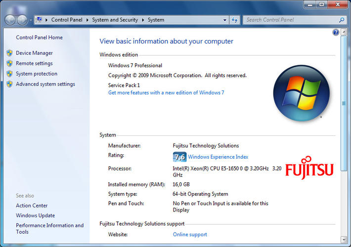

    On the Fujitsu workstation computer with the performance as depicted below
    CPU only rendering took 15minutes 18seconds
    when using GPU for rendering it took 3minutes 34.87seconds
    1024 x 728 - 127K
    814 x 573 - 171K
    814 x 573 - 175K

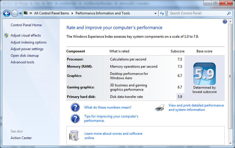

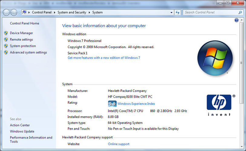

    On the HP computer with i7 860 at 2.8GHz
    http://ark.intel.com/products/41316/Intel-Core-i7-860-Processor-(8M-Cache-2_80-GHz)
    8GB of RAM and the performance in Windows 7 Professional as depicted below
    rendering of the file monkeys.blend with CPU took 28minutes 13seconds.
    1280 x 978 - 183K
    913 x 562 - 175K
    818 x 514 - 176K

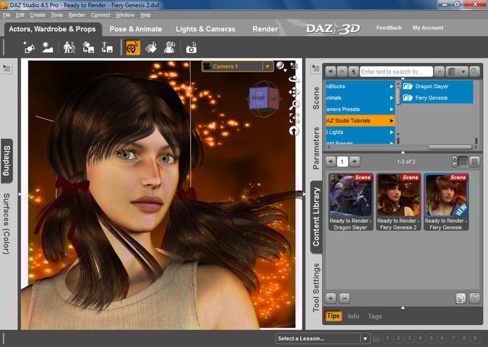

    Next test I have done in Daz Studio with the tutorial scene "Fiery Genesis 2".
    On Fujitsu workstation I have installed Daz Studio 4.5 Pro.
    Render time with the default settings on this computer was 2 minutes 32.97 seconds.
    On HP workstation computer I have still Daz Studio 4 Pro.
    Render time of the same scene on that computer was 6 minutes 23.2 seconds.
    600 x 600 - 123K
    431 x 600 - 59K
    1024 x 728 - 288K

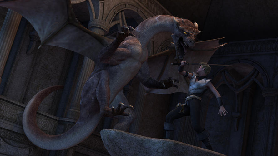

    Another test I have done in Daz Studio with the tutorial scene "Dragon Slayer".
    On Fujitsu workstation with Daz Studio 4.5 Pro installed
    rendering time with the default settings for the scene was 1 minutes 36.13 seconds.
    On HP workstation computer with Daz Studio 4 Pro
    rendering time of the same scene was 3 minutes 38.16 seconds.
    1280 x 720 - 234K
