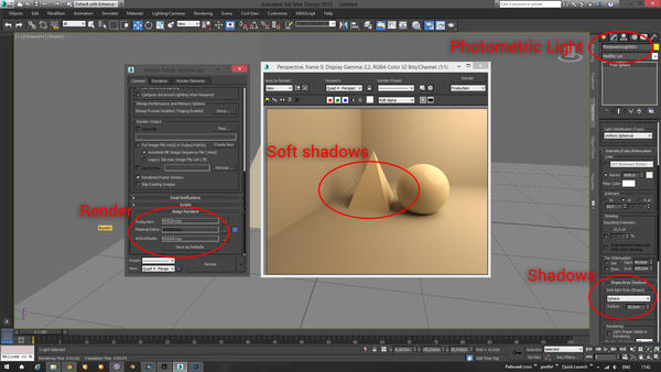

    To Peter Wade:
    Look to the 3D Max before :)
    On this screen you'll find all about I told.
    I use just one photometric light. I set Sphere geometry for light and for shadows. Sphere geometry makes soft shadows. More sphere - more soft.
    In the DAZ we have just a little part of the iRay settings and only half of them are works right :)

    I don't know anything about 3D Max but it looks as if you have told it to create a 30 centimetre sphere that emits light. The size of the light compared to the size of the objects determines how soft the shadows are, it's simple geometry, and reflections from the walls will soften the shadows more.
    If you create a 30 centimetre light emitting sphere in Daz Studio you should get the same effect. I haven't explored IRay enough to find out if you can create light emitting objects (you certainly can using Reality/Lux Render) but Daz Studio with IRay is still a beta version.

    Look better :) This setting called "Shape/Area Shadows". It's a setting of the Photometric light, and not of the mesh light :) And no need to tell nothing If you don't believe your eyes when you look on my screen.
    Photometric lights in the FULL version of iRay have a settings for shadows. Possible to set any shadow from directional to deep soft..
    If you'll set sphere geometry for light in the DAZ you'll be have only black directional shadow and no more. I hope that we'll be have a normal iRay in the DAZ, but right now in the beta-4.8 works right only HDRI light.

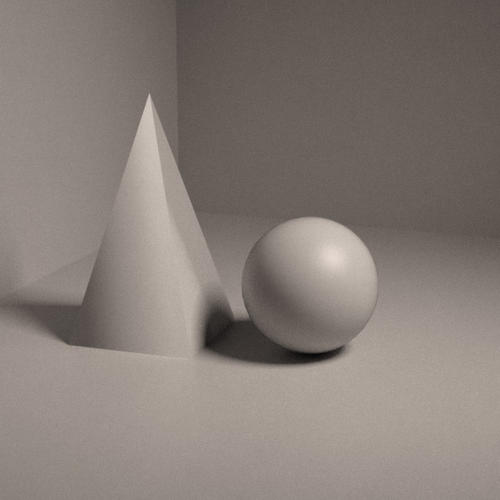

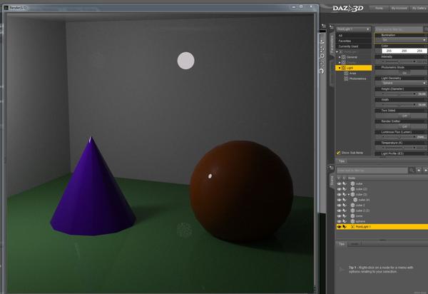

    If Chuckdozer will forgive me, this is a simple scene (six scaled cubes, with a cone and a sphere placed in the "room" they make) lit by a single point light at front left as you look at the scene set to a 30 cm sphere. You can see light bouncing into the shadows, and the shadows having softer edges (especially on the cone, which is nearest to the light).
    1591 x 1092 - 165K

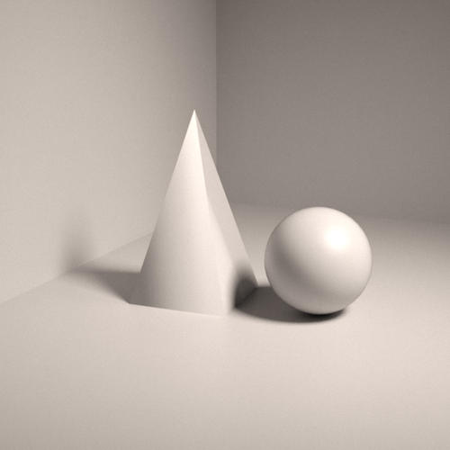

    I think I found a way.
    Linear Point Light, setting of light "Cylinder"
    Just a simple test render
    556 x 720 - 210K

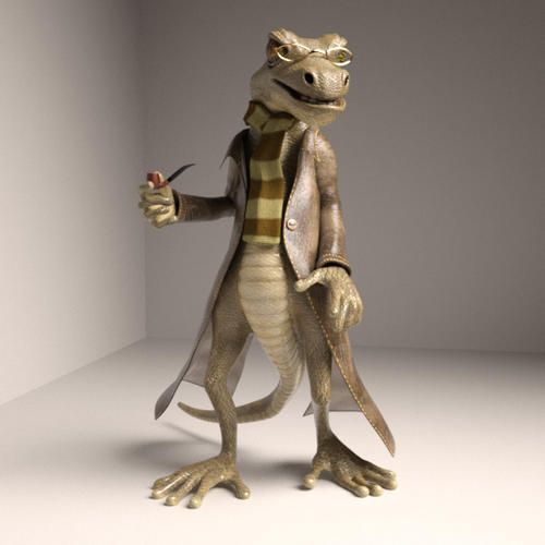

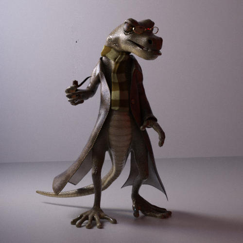

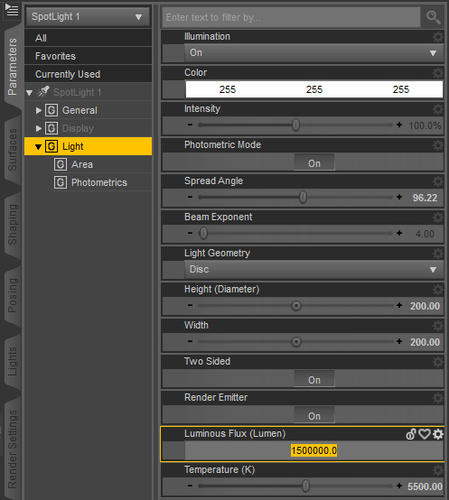

    These two images were both rendered with the same spotlight. The only difference is the geometry setting of the light. Size of the light geometry in each image is 200h x 200w. "Double Sided" and "Render emitter" are both on.
    In the darker image, the light geometry is "Sphere". In the brighter image the geometry is "Disc". While both geometries are the same size, the Disc has less surface area than the Sphere, but the light is distributed through the scene very differently. The softness of the shadows is dictated by a combination of the size and shape of the light geometry, the distance of the light from the subject, and the brightness of the light... as well as how much geometry surrounds the subject to bounce light back.
    497 x 554 - 130K
    615 x 615 - 81K
    615 x 615 - 107K

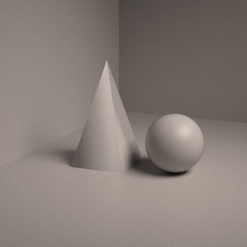

    These two images are lit with the same spotlight as the last two images. In the brighter image the geometry is "Rectangle". If you compare it to the image rendered with "Disc" geometry, you'll notice that the shadows are a tad bit softer. Again, more light area equals softer shadows.
    The darker image here has the light geometry set to "Cylinder".
