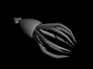

    My paying render got done a bit early so I was able to knock out an animated gif!
    This is very simplistic. I basically animated the squid by expanding and contracting the extrusion envelope like a bellows, so it is not very accurate or elegant. If I wanted to, I could have gone in and manipulated the tentacles by moving the shapes in the cross sections around as well.

    Here's a new version of the animation where I moved the shapes on the cross sections, rather than moving the envelope. If you downloaded the scene file already, it has been updated. I also changed the tweener type to bezier.
    Most of the shapes were pretty easy to grab and move, but the ends of the tentacles were very small and when I clicked and dragged them, they wanted to expand in size, so that's what I did. When I was done, I set them back to their original size numerically.
