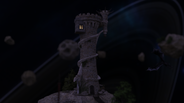

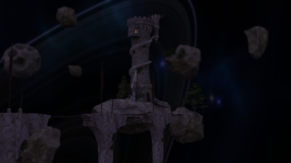

    Now I'm converting my project to iray from Octane. I'm able to keep the frame render time within 2-3 minutes without the loss in quality and sometimes (especially with large amount of lights) iray converges faster than Octane.
    Not to be unfounded, these are rendered in 24 seconds each, no postwork, just iray internal tonemapping.
    1280 x 720 - 680K
    1280 x 720 - 666K

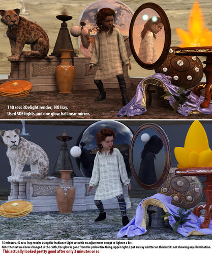

  • philiphowephiliphowe Posts: 53
    Yes, I've tried that but the resolution for my scenes becomes so low that it looks very grainy, especially with any emitters. With the timer, it sicks to that time frame, 15 secs being the lowest, so after I test a few frames, I can go up from there if needed.
    I'm doing an interesting test right now that is nearly finished, a comparison to Iray at 30 secs per frame, 4.5 second animation, VS the same amount of time per frame for Octane. I used several odd props for a variety of textures and will try to include a few notes as to what happened. Its just finishing, with Octane rendering the 147 frames in a little under 90 minutes (and the set up was considerably easier, which saved an hour or so) and Iray rendering in at a little over 90 minutes. I did screen shots of the Viewports for those who are interested and haven't seen either renderer yet. I will attach them here and attach the animations after I run them through Premier to reduce them to a size I can send. (I think, one is now 11 mb, hopefully I can just attach it. I don't want to mess with Youtube.)
    Before I forget, with Octane, you can see each frame render and adjust to the next frame. I only saw the same first frame with Iray. You can also stop the animation (I do PNG stills) but I think you can continue the render with Iray. It would be nice if Octane had a psd opr tif option. Some of the objects (textures) did not even show up in Octane, like Jepe's shiny cloth, the mirror, and a mirrored ball I put in, which I just used Octanes online textures for. In Iray, most textures worked but some lost their sheen, etc. Its all in how much time you take to set up the files. At least with Iray, you get what you see. With Octane, since its basically another program (plugin), the textures won't always show up right, same as with Reality. But this is rarely a problem and using their mats works very well. Its done, I will put it together now. Meantime, here are a few screen shots, one shows the viewports, one shows the same image, sort of a crazy piece I threw together, as rendered in 3Delight vs Iray, with notes. I had to reduce these down.
    1667 x 2000 - 1M

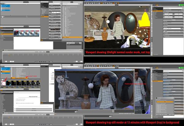

    Here are the viewports for the above renders, with notes.
    2000 x 1366 - 727K

    My notes- The first thing I noticed, besides the crazy flying pancakes, is that the dynamic cloth did not hold up well in Iray. I assume this is because it needs a lead time to set up, can't just render before it moves into the next state of forming around the figure. Why it works in Octane, as it nearly always does, I'm not sure, but I assume there is a short delay before it loads the next frame. Again, you can see it render, frame by frame, in Octane only. These animations show this clearly, so I am hoping they will work on this. Dynamic cloth is the closest thing to a physics engine Daz Studio is likely to have, and the results can be worth it, but if it won't render in an animation, that could be a real problem for those few of us doing video work.
    As far as realism, both look very good. If I played with the lights and set up emitters, the realism would increase, but these are just simple light setups for each with no additional lighting. Both were rendered at 30 seconds per frame, both rendered in 90 minutes. These seems to be more depth with Iray, but more luminance with Octane. Once Iray gets better lights and I try more shaders, I'll test it more thoroughly.
    I probably should have rendered the Iray setup with just the default sun light, not the purchased softer light. It would have showed shadows and looked closer to Octane's default 'sun' lighting. But I never use those alone, always with added lights or overlapping the full render at percentages while layering in After Effects.
    The grain in Iray is very obvious. With Octane, very little grain for a 30 sec per frame render. There is no grain after 3 minutes or so, but that would mean fairly long render times for animations. Might be worth it, though. Again, it would be more fair to compare the sun effect, although in the stills I did, the length of time to do a render in Iray is still much longer than in Octane to get to a non-grainy look. I think that answers someone's question. For stills, Iray is definitely worth delving into. I think you would need to buy some of the new items for materials, shaders for metal and cloth, etc. Most of them hold up well but the shine is gone, fixable in the surface settings, I would think. Still, that is a lot of experimenting to get one scene ready.
    Kind of fun to compare. I am sure they will incorporate more and more new stuff to try. I hope there is a way to do some nice fog effects and utilize the 'bloom' feature, which is very sensitive but looks pretty cool. The selective focus alone is worth working with. I will try to figure out why I can't get a dome to render. I read some notes that this is possible, perhaps as an emitter, but have not been able to get any object to radiate light as an emitter, yet. With Octane, you simply right click and make the object an emitter, very easy to do.

    Hi--do you have a tutorial on your process. I too would love to use Iray for animation ...:-)

    The process of conversion from Octane to Iray is simple - it's all about making iray materials and writing a script to apply them to old Octane-based scene in a batch manner :) As most shots reuse the scene setup (more or less) script will save you some time, but the same actions may as well be done manually.
    About animation process iteslf - I wrote something here http://www.daz3d.com/forums/discussion/57649/
    I'm too lazy to make tutorials, sorry :)
