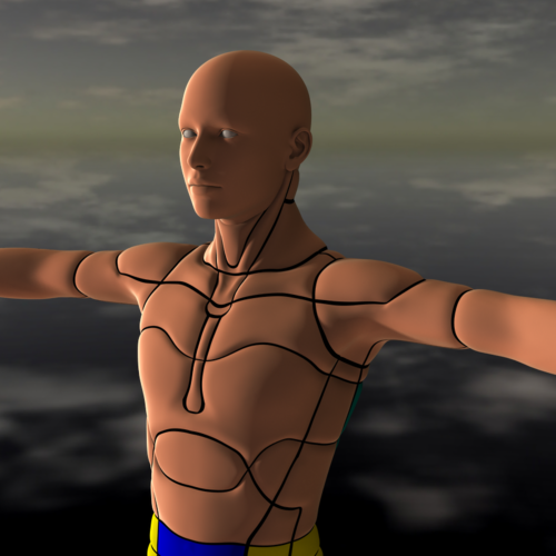

  • JaderailJaderail Posts: 0
    Okay I did this in no time. I'm still at a loss of how to get skin on the skin parts. Maybe with the Default Skin shader. But if this is close to what you wish to do it is easy.
    800 x 800 - 585K

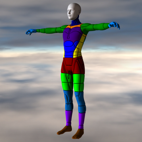

    I ask again something like this?
    800 x 800 - 615K

    It was not hard. I loaded Genesis and turned it all off with the EYE's in the scene tab except for the neck and head. Then I loaded the Supersuit and used the SHAPE presests for Seams pushed in. I then used the Default skin shader to put the texture on it one texture zone at a time. The face is still Genesis so it could have a better texture but then it would not blend as well as it does. I did have to read the Supersuit doc file to understand how texture it fast and easy.
    I can not get the head shapes to work so I just hid them. If you play with the scale of Genesis you might get those to work also. I'm not sure but if you are not in a hurry you could try it.
