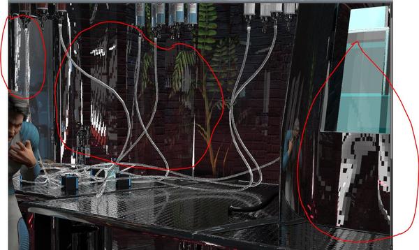

I've bought Liquid Lab, and I think it's a great set. :-)
Unfortunately, when I use the "Load all" setting, it gives me weird squares in the render.
Does anyone know what could be the cause of this?
1196 x 713 - 177K

    I started a render but cancelled it waaaaaaay before it got that far a sit was crawling along at a snail's pace - a quick check showed that the caustic glass shader was used a lot (which I have always found to rival glaciers for slowness). A massive re-texturing ensued and re-lighting ensued which improved things a lot, but I still did not get that far.
    Do you still get those artefacts if you do spot renders of the offending areas?

    If you are using 3Delight, check Render Settings > Sampling, and look at Max Ray Trace Depth. Reflective surfaces needs around 3 or so, I think.
    Another possibility is checking the mesh resolution of the objects. If it's Base, try using some SubD.

    Looks like reflections are active on those surfaces and smoothing appeats to be off.
    Youmay want to open a ticket with Customer Support if these things are that way by default

    For that scene, going as high as 8 or more on the MRTD would not be uncalled for...it looks like there are several 'stacked' liquid/glass items in that scene. Each 'layer' of that stack will need at least 2 'bounces'.
    Also, turning ON progressive rendering will speed up the render, by a considerable amount. Even with progressive on, higher ray trace depth will increase render times.

    I did as suggested and increased the Ray traycing. At setting 3, which is what comes with the set as "promo render setting", there are still squares visible. So the raytracing is not really solving the problem, IMO.
    I have now increased the raytrace to 8, and will see what happens.

    Make sure there's only one of the whatever-it-is loaded - that looks a bit like the effect of two overlapping objects.
  • BeeMKayBeeMKay Posts: 7,019
    There's no overlapping I can see, and the object's just there once, according to the scene list.
    To make certain, I have deleted and reloaded it, but the effect remains. :-(

    I've found out what caused the squares in the render....
    It is... *drumroll* the drapes! :roll:
    I've removed the drapes at one side of the lab, and the squares in the vaporizor were gone. The ones at the wall, where the other drapes are, remain.
    As the drapes behave all nicely in the promo renders, I guess that something is wrong with them. I'll try the subdivision increase on the drapes next.
    EDIT: Okay... so increasing the subdivision on the drapes to 2 makes the squares a little bit smaller, but they are still there.
    I'm open for suggestions. :-)
    1512 x 788 - 200K

    From what i can see, there's a reflection on the drapes, which is the strange "squares"?
    The one on the plant in the image above, third red circle from left, it kinda looks like "refraction" - you know when you put a pencil in a glass of water, and it appears "bent" due to the light through the water? (forgive me, only just awake right now so may not be making sense). Have you checked the surfaces of the drapes to check out the shaders on them?

    Those 'artifacts' to me look like reflections/refraction against non-smooth surfaces then being reflected elsewhere. I would imagine setting the RT depth even higher might actually make it worse. The red stuff? The source tubes look like they have black straps of varying widths, then the reflections of course show that in an odd refracted/offset way, and the reflections of those reflections break up the red even more.
