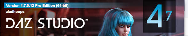

    Hey man thanks for the reply , So Im using Daz studio 4.7, As seen below, And I took a screenshot of the light settings I have

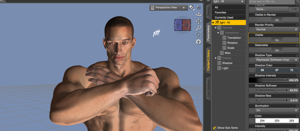

    Your shadow softness is very high - you may well be washing the shows out completely except for very close to the item casting the shadow.

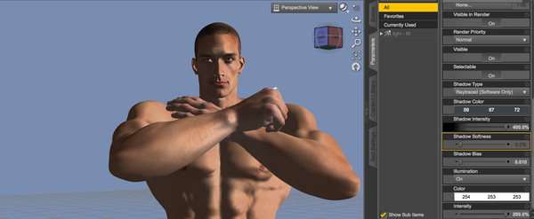

    Okay But I put the Shadow softness down and it still doesn't fix my cast shadow issue?
    1221 x 503 - 284K
  • Richard HaseltineRichard Haseltine Posts: 112,124
    Are there any other lights in the scene? If you select the light from the view picker (the button labelled Perspective View) does it have its view of the body blocked by the arm, which looks to be the most likely place for a cast shadow to be visible?
  • ziadhoopsziadhoops Posts: 7
    Nope thats the only light I have in the scene, And when I did the light view in the Perspective View it was on the top and it seemed like the cast shadows should be visible

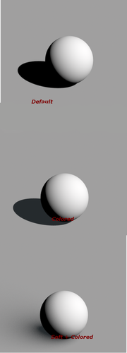

    Also, going with anything other than black automatically lightens/softens the shadows..
    The differences between each one are...the shadow color changed to what you posted in the screenshot...then the shadow softness set to the same value as in the screenshot.
    Also, just for kicks and giggles...post a screenshot of that scene, with the light turned off.
