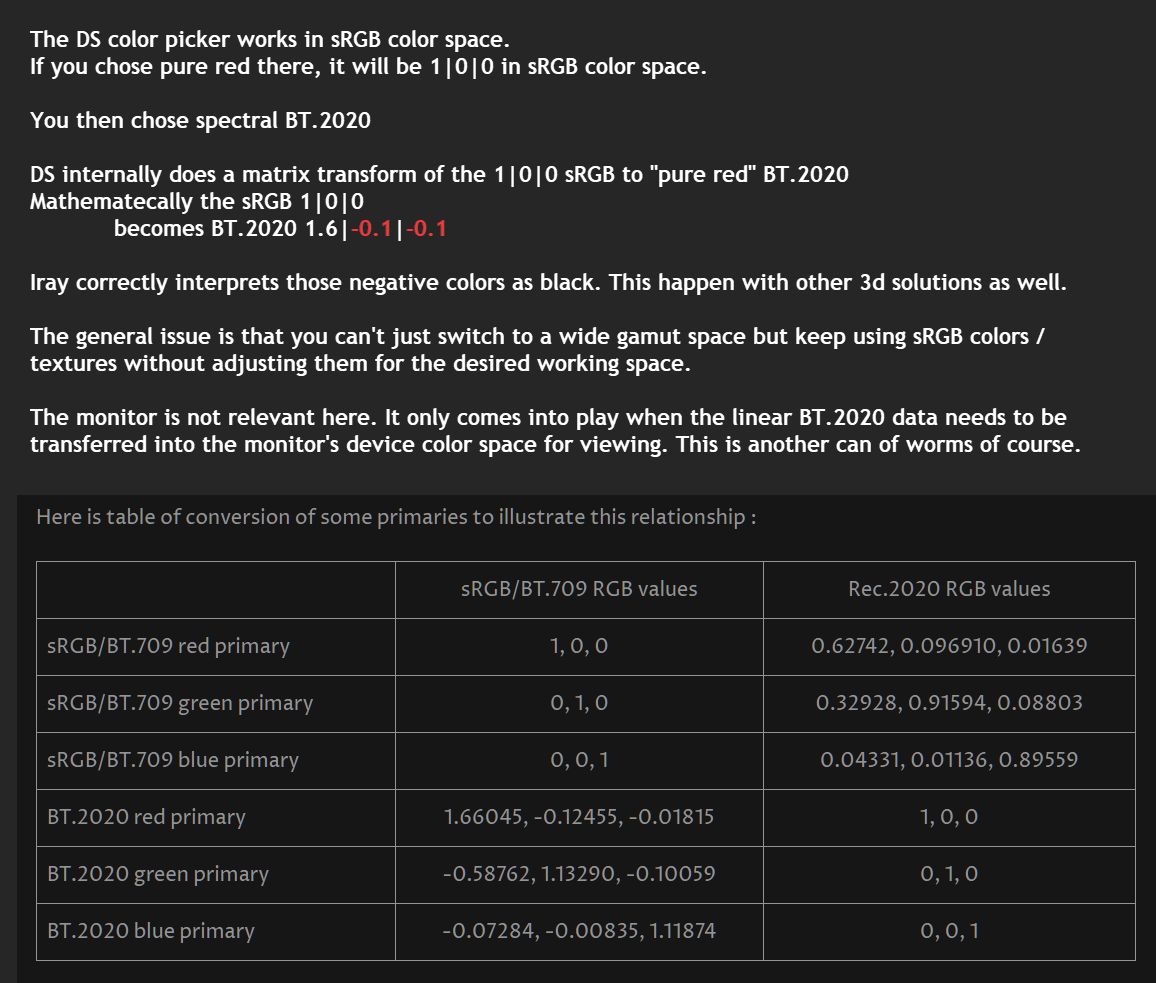

    There is no one click solution because there is not a technical problem but a missconception about what happens. This link https://chrisbrejon.com/cg-cinematography/chapter-1-color-management/ is the one to read about the concepts. Normally I post something like "click this button to solve your issue" but in this case one need to understand the background mechanics to utilize something like BT.2020 or ACEScg.
    Regarding the "black" color:
    I was in the same boat not long ago and read a lot of information to understand what's going on. Below is my simplified answer of what I understood:
    Technically it would help if the color picker could be switched to the desired working space. E.g. in Resolve, Nuke etc. you can do that. That would solve the picked color issue. But, the textures made in an image editor could still be an issue if that one still works in sRGB.
    Example: pure sRGB picked in DS and rendered as BT.2020
    1156 x 983 - 124K
    500 x 698 - 52K
    Post edited by cgidesign on

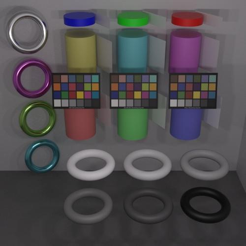

    Here are two renders out of 4.20.0.12 beta:
    Non spectral with default tone mapping.
    Spectral REC.709 with default tone mapping:
    500 x 500 - 140K
    500 x 500 - 145K
