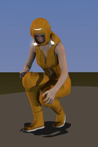

    Make sure you select the "Model" that's rigged, rather than the bones themselves, then the "Detach" option should be available, since it's the object that has the bones attached.
    The worm sounds interesting,. I've been working on some stuff recently and I used morphs to generate some of the animation in sea anemone's rather than rigging them and key-framing. i just used the Morphs, and the oscillate tweener to animate them.
    I think It's important to remember that you can use both rigging and morphs to animate the model.
    HI Wendy :)
    I've not used FBX for a while so, I'm not sure why it would lock up after editing the skeleton... strange, maybe it's protecting something,
    HI Stu :)
    More like dunderhead these days :) I'm still struggling with 3D-coat, but I also jumped into Z-brush, which has a plethora of new tools and options to learn.
    I'm also finding some new stuff in Carrara, or, improvements in what's possible with DS, like making figures and conforming clothes in Carrara. and rigging them in DS using the transfer utility. which makes Carrara a content creation tool.
    Edited to add ....Evil beat me to it :)
    600 x 900 - 26K

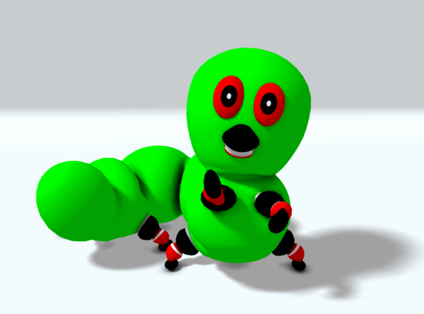

  • terstatersta Posts: 11
    Wendy,
    I think your tip solves the mystery. I had exported to FBX and then imported that to stage, so I posed it. Then I went back to the original and wanted to use the same pose, but couldn't figure out how to save just the pose, so I started working with the FBX...then realized I didn't like the rig.
    It didn't even occur to me that Carrara would care if I used a native or imported rig. Well, now I know. LOL!
    Here's a render of the exported/imported FBX. I can see that the constraints didn't import and there's some weird weight mapping on the front that I'll have to fix before I add a swank texture.
    Thanks to everyone trying to help.
