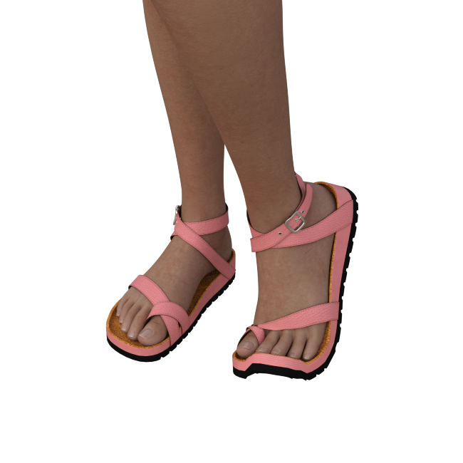

    They work on G8F for most poses but get distorted badly on a few. Here's an example of that.

    Adjust the weight maps to remove or at least smooth the influence of the toe bones.

    How do we access the weight maps to adjust them?
  • GordigGordig Posts: 10,810
    The node weight map brush (Alt+Shift+W).
  • felisfelis Posts: 6,546
    And then select a bone in the scene tab, and open Tool Settings and select General Weights.
