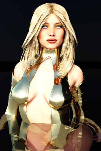

This is the result I got by setting a plane and making it water, and by changing the top layer weight to 1. The skin certainly looks more glossy. Thanks.
My next question is, How do I change the direction of the reflection? I have moved the sun dial and it still reflects right in front of my image. Thank you :)
I'm not sure if it is possible to change the way something is reflected. It isn't due to the lighting but due to the figure placement vs the reflective surface.

Do you maybe still have the camera headlamp on? The reflection is determined entirely by the lights in your scene.
