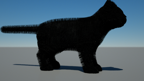

a quick transmap try

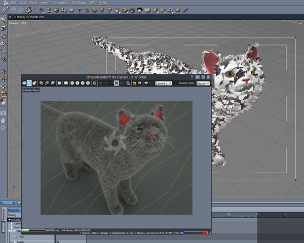

having bone ticked results in many freeze ups
I tried the sparse 100 hairs on milcat and it just froze trying to pose and had to kill carrara a few hours later in TM so not too confident about a full coat

I couldn't recreate the lock up, but Grows definitely isn't playing nicely with Millennium cat. The strands are flickering like the mesh is changing ordering as it animates. I'll dig into it and see if there's something I can do.
Thanks,
Okay, found the problem with Millennium Kitty. If you'd like to give it another whirl, there's a beta version of Anything Grows for Carrara 8.x Windows 64-bit at

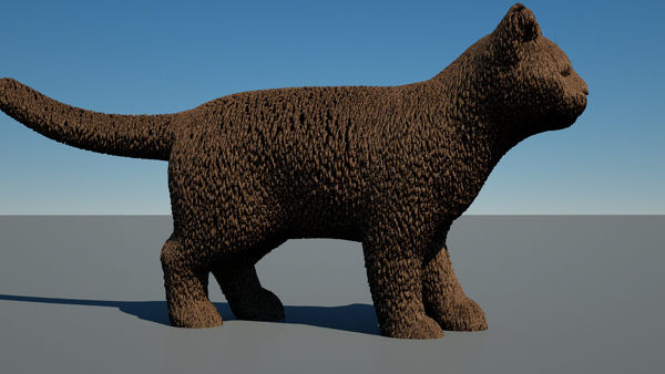

The attached image is not art, but shows what 50k alpha mapped strands look like in the Octane renderer demo.
Here's what I did
1. Built my animation first. It just makes everything faster if Grows isn't trying to keep up with you animating.
2. Insert an Anything Grows primitive. Because it can detect the difference between model time and render time, it keeps the UI snappy as you work. It doesn't need to generate every strand all the time like the Modifier.
3. Select the Anything Grows and switch to the model room.
4. Choose Base Object = Model and click the Line Up With Base Object button. The other options are listed below
Width = .1ft (depends on your scene magnitude)
Length = .05ft (depends on your scene magnitude)
Strands = 50000
Bone Mode = checked
Restrict Strands to Domain = Fur
UV Mapping = UV along the strand
Show Base = unchecked
This sets up UV mapped strands so you can alpha map them, makes Grows just show the strands, and constrains the strands to the Fur shading domain.
5. Switch to the Texture room. Let it create a new master shader. You should see a bunch of shading domains for the Anything Grows objects. They mirror the domains of your base object and add one for the strands.
6. Create a new shader in the Strands shading domain.
7. I Googled for hair strand texture and used an alpha map I found here http://gallery.mudpuddle.co.nz/main.php?g2_itemId=4240 , then adjust the color to taste.
8. Move the time scrubber to the end of the animation. Return back to the Model room and set the Animate slider for Anything Grows to 100%.
9. Render!
Now of course there's still work to do. In this case you'd probably want to build a custom texture to drive the length of the strands so you can make them short on the face and paws. You might also create a 2nd Anything Grows object to do the fur on the inside of the ears where the strands are very sparse.
The drawback to this is that since you're mapping the strands to do an alpha map along it's length, you can't really color the strands using a texture map for the kitty (e.g. tortie texture). You're stuck with a solid color kitty. You might be able to do some global space stuff with Procedural Lock, but I haven't tried it.
You could also go straight strands and allow the strands to pick up the UV of the point of origin. That would get you a cat you could apply a texture to, but the alpha really does help sell the fur look for far less polygons.

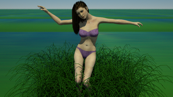

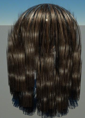

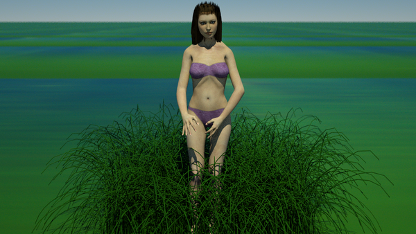

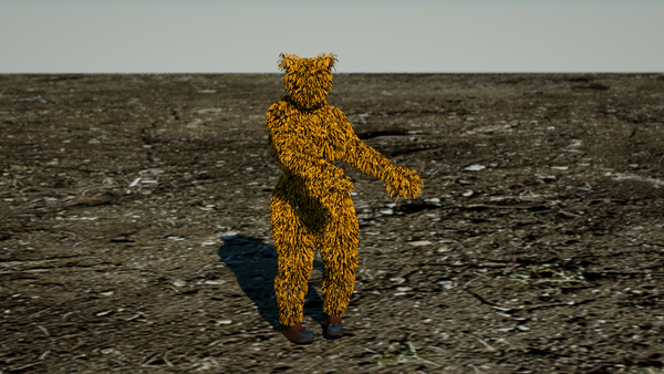

I just finished a V4 many stranded head hair and while octane rendered it quickly once the mesh was compiled, each frame it compiled it again which took several minutes, a carrara render would be far quicker, I am going to upload that soon once my PC stops calculating the next thing I tried, grass!!! Is all tied up at moment, am on my android tablet.
which is actually rendering quickly
far less thicker transmapped hairs on V4 made a huge difference too
https://youtu.be/sGuiu_12BAE
needs a lot of work still, just figuring out settings that render

furry genesis character flat mapped one skin working better using modifier on model itself
slow compiling mesh in Octane between frames but not too bad
