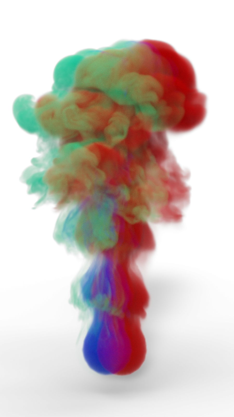

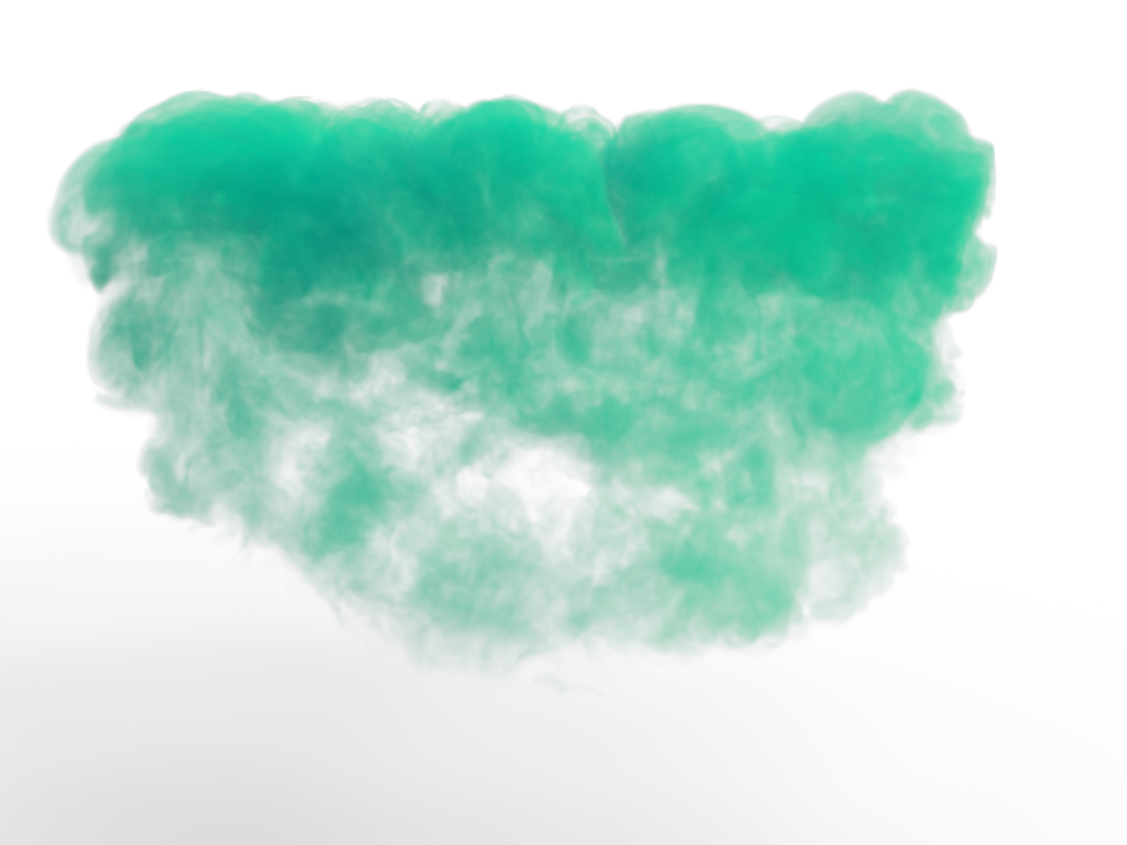

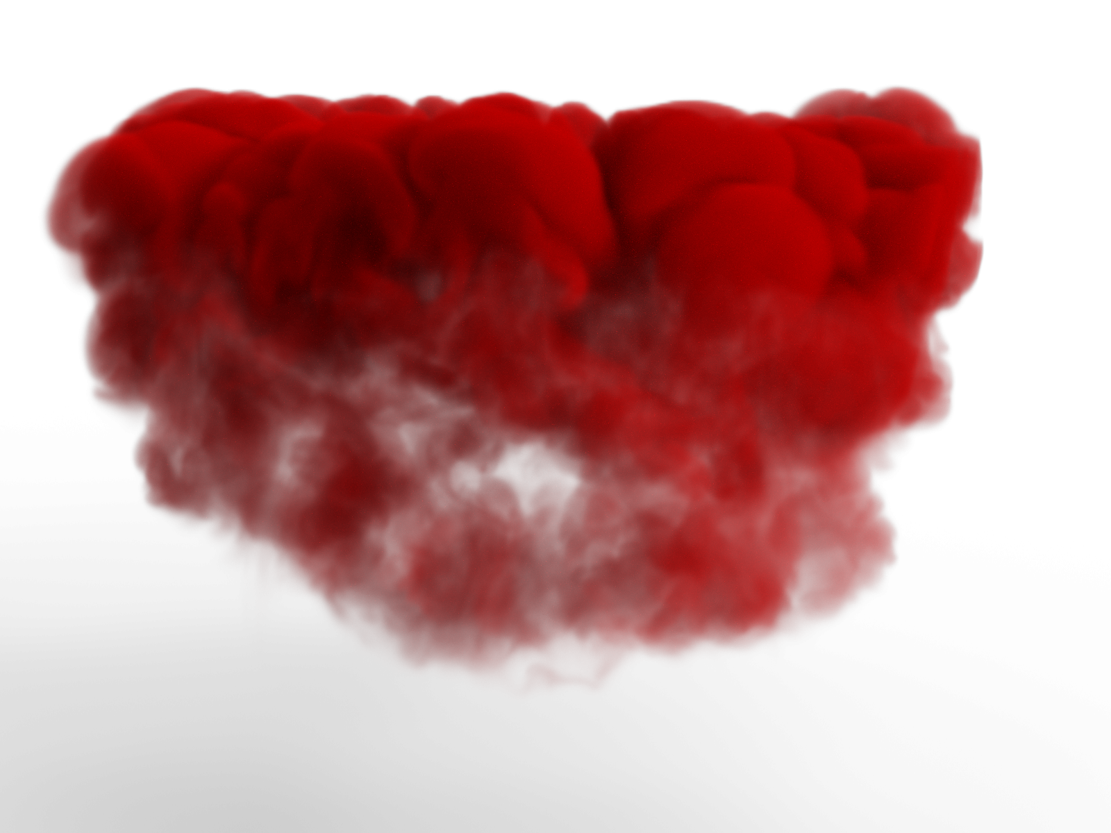

    I tried adding that property and rendered three iterations of the same VDB using different fields. I changed the scattering multiplier for each of them (I'm still working out how exactly the two properties are supposed to work, so any color changes I make are just guesses), and here's what the final result looked like:
    And here are the three fields separately.
    Fuel:
    Heat:
    Density (smoke):
    You can definitely see that all three fields are rendering simultaneously, although I could probably pick a better frame or make a more targeted VDB to better demonstrate the differences.
    1600 x 1200 - 2M
    1600 x 1200 - 924K
    1600 x 1200 - 1M

  • barbultbarbult Posts: 27,479
    @Gordig if you change the priorities of the VDBs, does it look any different? If you don't even add the new property, does it look any different? For me, I couldn't see that the new property did anything. That's why I asked if I did it wrong. I wonder if the particular VDBs used makes a difference. I never got those colored rectangles you showed earlier.
  • GordigGordig Posts: 10,797
    The rectangles I got were from physically offsetting the cubes from each other. I can test to see if that still happens with the new properties, but changing the render priority of the different cubes didn't really seem to make a difference. I'm fine with that, if it solves the problem of multiple VDBs canceling each other out.
    edited March 2022
    Well, I tried both changing the render priority of the different fields, and offsetting the cubes that contained the VDBs. As far as I can tell, changing the render priority makes absolutely no difference, but offsetting the cubes no longer creates abstract art. I'll have to try doing it to a regular cube to see if the problem is entirely solved, or if simply adding that property is what makes it possible, even if the property has no other purpose. It might be one of those quirks like renaming the surface to "Volume" in order to prevent clipping to geometry, and is one other reason it would be nice if Daz incorporated a new volume primitive object.
    900 x 1600 - 1M
    Post edited by Gordig on
