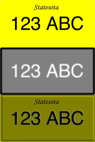

    A bump map should work pretty well. It doesn't create actual geometry, just a lighting effect at render time.
    Use a Gaussian Blur on your black and white bump map to simulate rounded edges.
    Here's an image map, followed by the bump map, followed by the Carrara render.
    (Click the image for a larger version.)

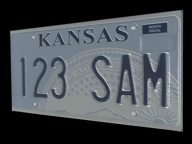

    I took the liberty of downloading your example image - simply made a greyscale and reversed - used a grid set to the proportions of the original. Placed the original in the colour channel and the greyscale in the bump channel.
    640 x 480 - 28K
