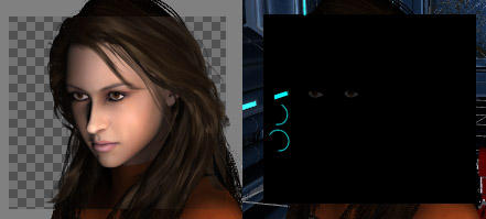

I'm trying to finish up my first-ever DAZ scene, and I've just run into a problem. When I render my character by herself, in a void, everything looks fine--she's being lit by every source I've set. When I make my environment (Biohazard: http://www.daz3d.com/biohazard-1 ) visible, all the distant lights stop working, and the only lighting left in the scene is coming from the point lights and linear point lights located within the hallway. Obviously I'm very new at this, but my understanding of the way distant lights work is that they're supposed to hit every surface in whatever direction they're pointed at, including going through walls, floors, or ceilings. Or am I wrong?
Here's a couple of quick spot-renders showing the problem:
441 x 199 - 22K
    If the 'cast shadows' parameter is ON (Parameters tab) for the wall/ceiling/etc, then NO, the light will not pass through it.

    I knew it had to be something simple like that! *facepalm*
    Thanks for the help. :)
