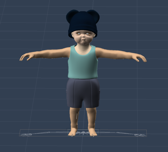

I have created a genesis baby. I was able to place clothing on him (millennium Baby clothes: non- genesis)
How do I rig the clothing so that it will move with the model when I create different poses.

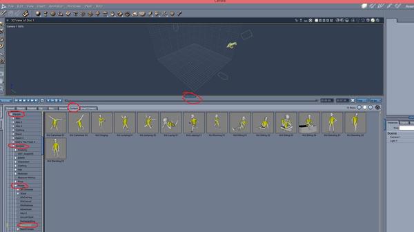

(b) How do I find the poses that come with him in Carrara? It is not showing up in Carrara under poses

943 x 853 - 186K

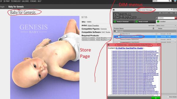

    RE: finding purchased genesis poses, etc.
    I don't have the genesis baby product, but I do have the genesis evolution morphs from which it is derived. Until someone with the actual product comes along, you might find the following helpful if the product producer used the same file structure.
    In Carrara's CONTENT browser tab (not smart content), look for a "people" folder within the My Daz3D Library. Within that, look for a "Genesis" subfolder. Within that, there is a subfolder for "poses" which are designed for Genesis. In the attached pic, I show a subfolder for "basic child" poses for genesis. If the producer used the standard approach, a similar subfolder may be there for the baby.
    However, it is not uncommon for a producer to create a subfolder for the character shape as a subfolder under Genesis characters (perhaps "baby"? or named after the producer?) This custom subfolder may have poses, materials, etc.
    If you don't find what you are looking for in an obvious place, and if you installed using DIM, you can check for file locations using DIM. Use the DIM search box to find your purchased product. Right-click the line with the product to bring up an options menu. Choose "show installed files" and note the path/location. Use Carrara's content browser to navigate to the location of the installed poses, etc.

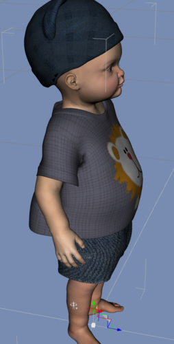

    Finally worked it out. Yay with lots of help. I needed to work from original Genesis rather than the baby in Carrara. Then fit it to genesis figure in Daz and then Morph back to the baby! Thanks heaps!
    Just a quick question. How do I fix up the shaping so the stomach doesn't look so big and also the back of the shirt etc?
    532 x 1048 - 401K
