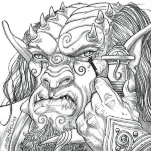

Is it possible to create this head/race type in Hexagon?
madmaxneo1madmaxneo1 Posts: 148
edited December 1969 in Hexagon Discussion
They are called the Gryx, many people fear them and call them beasts. But in truth they live a very peaceful and serene lifestyle mirroring the lifestyles of Elves, hobbits, or rural folk.
This is something I picked up in one of my game books and I would like to re-create this particular race.
I looked through some things like the creature creator but I didn't see any options that would help me create this race especially with the way the head is shaped, and with the multiple mini horns.
I also have Bryce and Hexagon. Should I use Hexagon or can I do this in DAZ?
Bruce
743 x 739 - 125K
  • madmaxneo1madmaxneo1 Posts: 148
    I am currently wondering if I will need Hexagon for this or not, as it seems that DAZ does not have the things I need to create this figure.
    This is a picture of a race called the Gryx. They look fearsome but are just the opposite and are a very peaceful people.
    I'd like to know if I will need any extra content for Hexagon or if I can make this as is in Hexagon (if I need to use Hexagon)?
    If it is possible is there a tutorial that might help me with this somewhere?
    Bruce
    743 x 739 - 125K

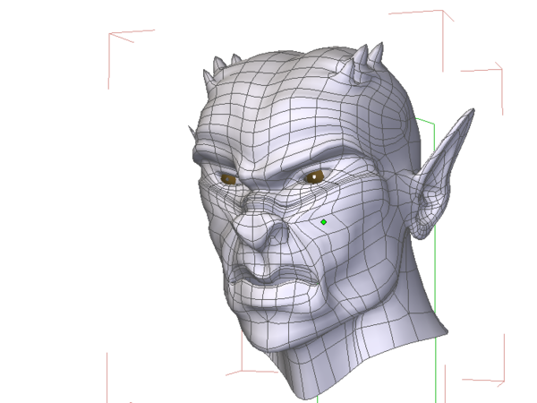

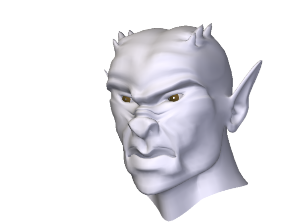

    Just for illustration, I made a start on changing the Gentle Face model supplied with Hex into this Gryx character - it would take a lot more work to get it completed.
    I wouldn't recommend a novice attempting to morph G2 into that face because the mesh is too dense to clearly follow the main edge loops and Hex's soft select isn't all that sensitive. There are parts, such as the horns, which cannot be done effectively without adding geometry, which nullifies morphing - unless you add them using geographting, which is a very advanced technique.
    As you can see from the edge loop flows, it would be better to do it as a whole, rather than in parts, because the edge loops flow all around and across the whole and it is important maintain a good flow to follow the musculature. Start rough and add more detail as you go.

    That's great work, Roygee.
    I know it's a first stab at it but if the chin jutted out more so that the face slanted it would be practically done.
    Then there are also Hexagon's displacement painting tools which I for one have yet to try.
  • RoygeeRoygee Posts: 2,247
    Thanks for the complement, but it's a long way from being satisfactory :)
    Just meant as an illustration that you don't need to start everything from scratch when you have ready-made starter kits provided with Hex. ideal for someone learning the ropes and needing a kick-off point.
