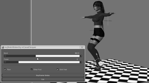

the impetus was
all those times when we pose a figure and one of the feet goes just an annoying 1/4 inch through the floor
so now, you select the foot, run the script, turn a slider a little and she pulls her foot up without bending her ankle

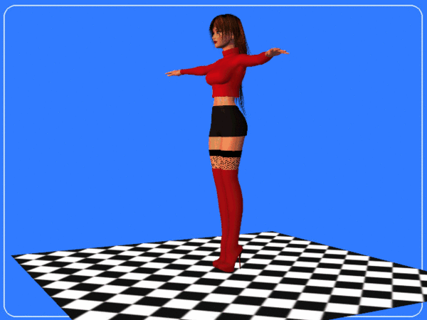

animated demo right here right now
in Figure 1 an animation made using 3 or 4 keyframed poses
the poses were done in just 1 second using the upcoming mcjStretchExtend script
but as you can see, due to curvy interpolation ( between keyframes ) the figure goes below floor level
with the new ''animate range feature', the script will do the interpolation and we'll get rock-solid grounding
got lost a bit in making an A4 swimsuit
but it's a good example of the use of mcjStretchExtend
we want the support leg as stretched as possible
and we want the other foot to stay resting on the ground
so we're still at the point where
the script works
i just want to add animatability

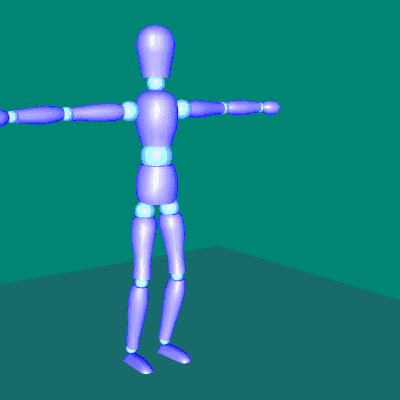

Figure3 ... the fixed pose! just using mcjStretch-Extend ( which i realized will definitely need some undo capabilities
Fig. 4 i also will add the ability to move the hip forth/side/up and rotate it ... without losing the feet grounding pose !
see that's the Hips Forth control
it's probably similar to the standard Daz Studio 'pin'
but precise and controlled i think
the feet will be even more stable than shown here
that's basically the first test results with moving hips !
we had Amy standing and about to fall, now we can move her hips forth and make the pose credible
